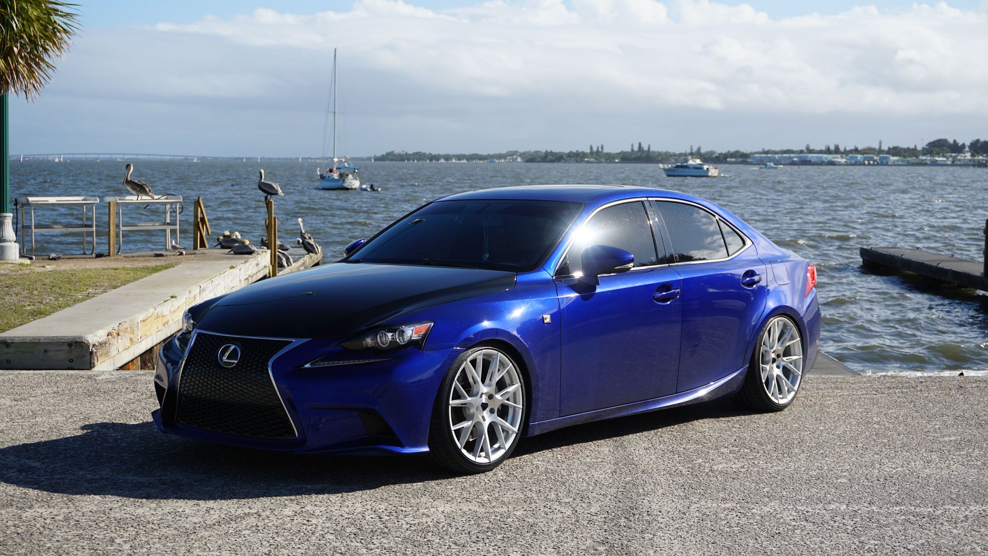

Originally Posted by Eric@BDWheels
Recent 19x8.5/9.5 set up we did with 235/30 fronts and 255/35 rears. I think the 19" looks really good on the IS.
What rim offset are you running?
My money is on +35 front and +40 rear.
Those wheels in that size are available as +35 and +40 for the front and +40 and +42 for the rear.
They mentioned minimal rubbing, which I assume is the rear, and based on how low it's dropped there shouldn't be rubbing with a +42, so likely the rear is a +40.
Very close! 32 in the front and 40 in the rear.
Thanks for confirming.
It was difficult to find the offsets for those wheels, had to scour a few different websites, and +32 was not offered by the one site I found that actually showed the offsets.
I had checked Blaque Diamonds website, but no offsets listed there...which seems odd as you are the manufacturer...unless offsets are custom, therefore no need to post them as they can be whatever you want/need.
We are currently working on updating the website with more information regarding specs and pricing. One of the reason we didn't display fitments before is because we do custom machining in-house, so most of our fitments are custom and made-to-order.
