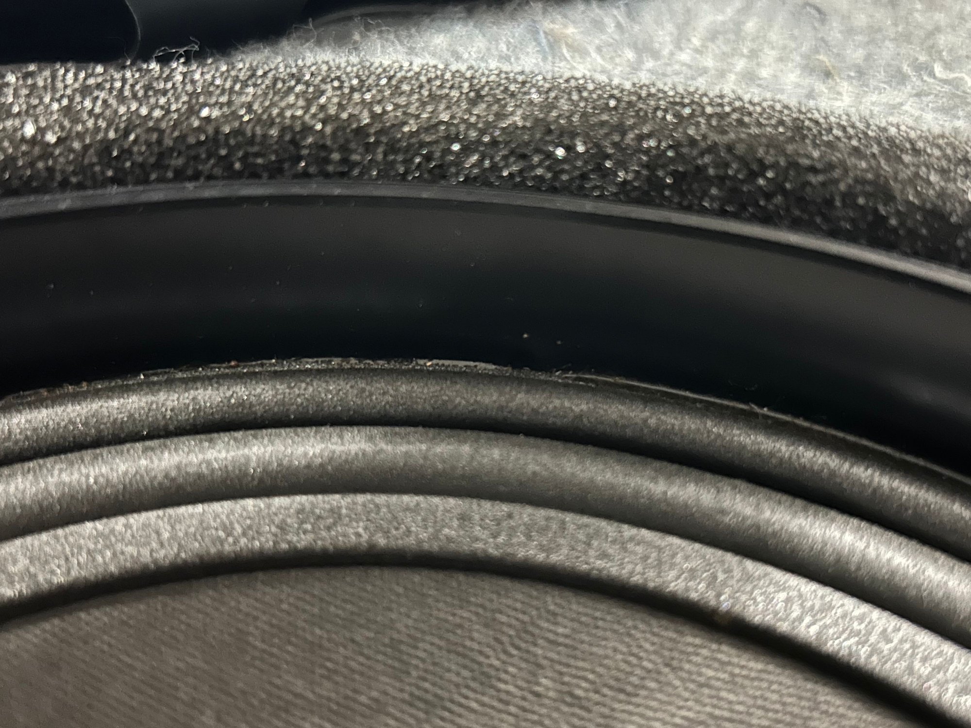

So I have a problem with it too. I was wondering if this is the “micro cracks that you are talking about? I also added a video of how it sounds so if you could tell me that it is similar or not that would be much appreciated. Thanks
