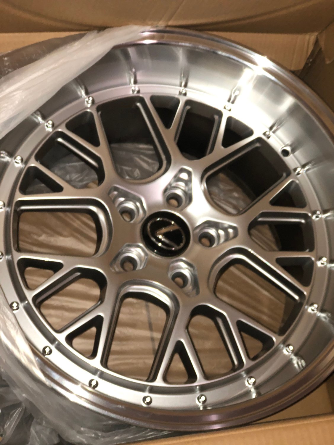

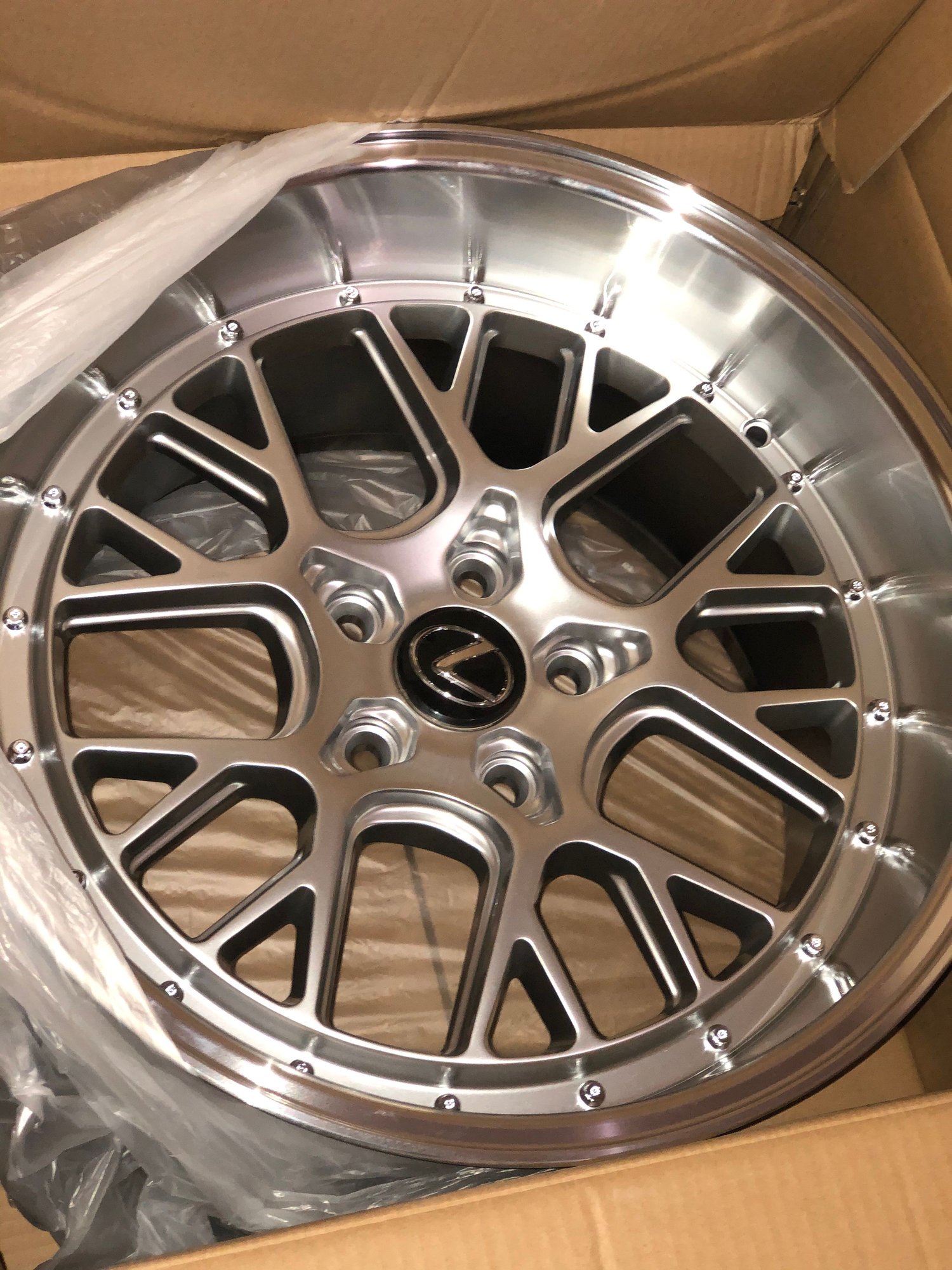

Planning on putting these on starting of spring next year
R: 18x10.5 +22 F: 18x9 +25 pics of test fitment coming soon

The MRM is looking good.
By the numbers the rims look like they will stick out notably beyond the fender.
Usually to fit a 10.5 on the rear the offset is around +45.
The front wont be as bad...usually a good fitment for a 9 inch is around +30, so it won't stick out much.
Are you lowering the car or cambering the wheels?
