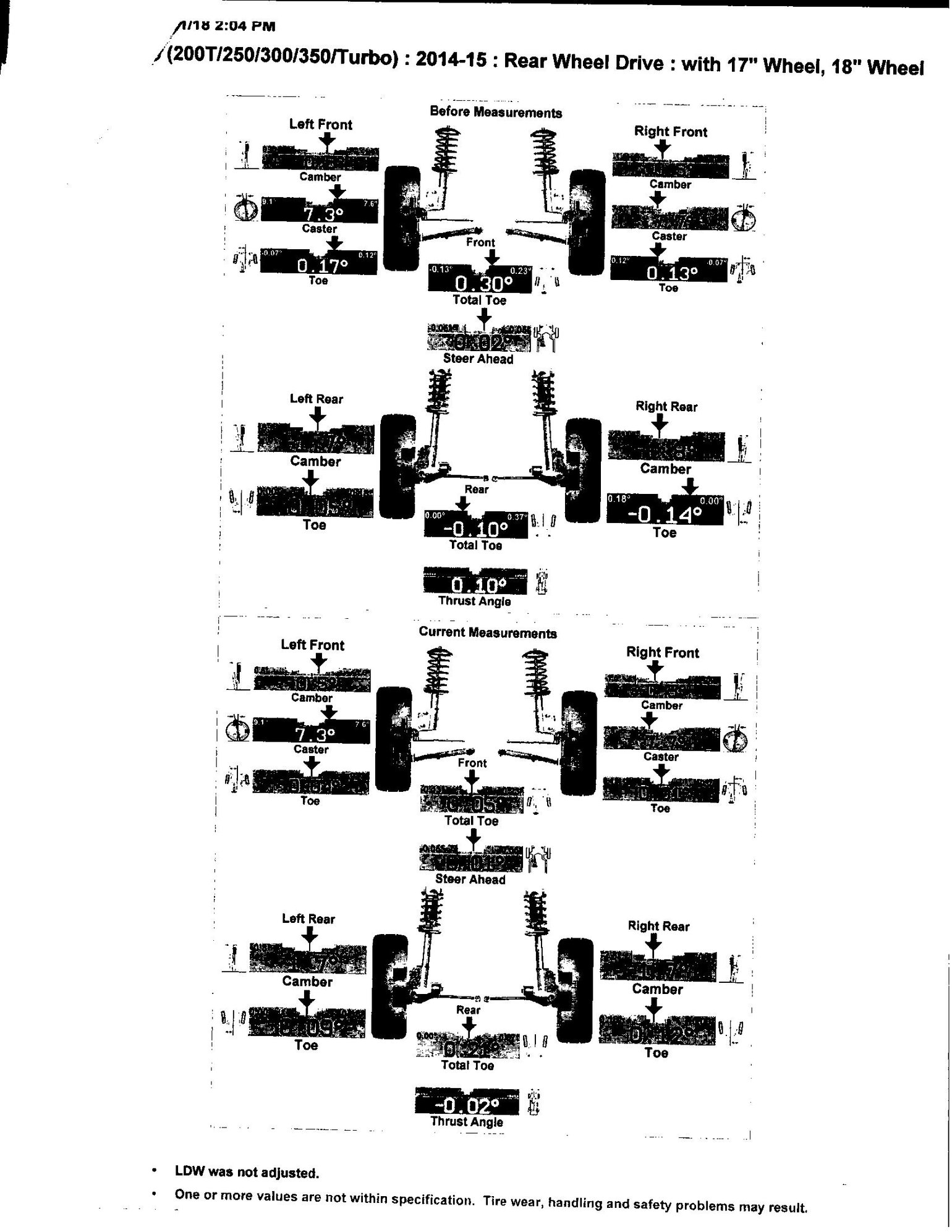

Hey all! Here is the alignment specs I just received from the Lexus dealership. I have no idea how to read it.
Also I had a friend drive my car last night and he definitely noticed it pulling left and right. I needed conformation so everyone doesn't think I'm crazy. ha It apparently does not veer left and right when Ive dropped it off at Lexus.
My car does not have lane assist and seems way more intense to be just a tire issue. Whatever the issue is I cannot wait until it is pinpointed and resolved.
I barely figured out how to load this picture of the alignment(I'm technically challenged sometimes ha) but I do have a video I would like to share. I will have to figure out how to load a video on here if that's even possible.

Don't worry about reading it...cause half the numbers are missing due to it being photocopied or scanned...or whatever was done to it.
It looks like the left front Caster is out of spec...which is odd. Possibly the right front too, but really hard to tell without a number or clear indication by the arrow.
The front and right rear Toe were out to lunch before...which they did bring back into spec.
The left front caster is a little concerning. They probably said it wasn't adjustable or they probably didn't mention it at all.
The lower control arm bushing on the left front would need to be changed to the correct offset one in order to correct the Caster.
Any chance you can read the numbers and tell us what they are? Or is that how they sent it to you? (which is pretty pathetic)

Any chance they can send you a readable version?
At this point the caster is an issue, and a significant difference in caster can cause the vehicle to pull to a particular side...the side that has less caster.
In this case, to the right. However that would not explain it pulling left.
Given how much Toe adjustment was made to the vehicle overall, the steering would need to be calibrated...if it wasn't.

Change all 4 new tires and do Alignment again, your rear is good but the front is bad , Front Camber and Caster is way off inward but thats not really the cause, Tires are , pump the air to +37 all around, take it to another Alignment shop. My IS350 pull left/right when i was test driving , i noticed 2 different brands tires right away, front were BridgeStone rear were Michellin they were bad.
Save your time with the Electric power steering system whatever for now because it will be a ton of headache. In modern car electric anything related to ECU you should get an Indicate warning light on your dash. they call it EPS etc.
