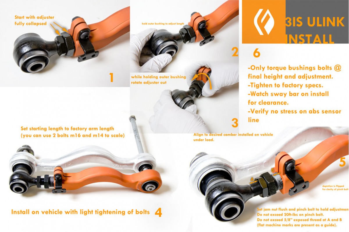

Going to install these on my 15 AWD this weekend. What are the torque specs for the 14 and 16mm bolts? TIA

last number is in-ft. so it's 111 and 140
here's how to install them.

Update- As of 2024, my experience is factory recommends 90 ft-lb but nut will strip at anything over 45 ft-lb. This is for RX 2nd gen 15mm rear SPC, assuming they are the same.
