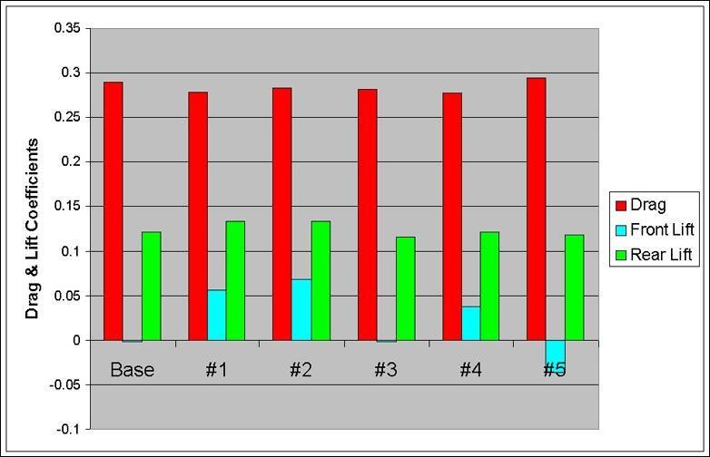

Not sure how they are measuring this but here is their data:
Conclusion of study:
  • A large deflector positioned well ahead of the wheel stops air getting to the wheel (good) but probably deflects air sideways, increasing the size of the wake (bad). Lift is low because there’s no underbody surface parallel with the ground against which the air can develop an upwards pressure.
  • A large deflector positioned just ahead of the tyre deflects air sideways (bad for drag) and with the horizontal undercar body surface ahead of it, provides an area for air pressure to build-up, creating lift.
  • A small deflector positioned just ahead of the tyre stops air getting to the wheel (good for drag) and isn’t so big that this benefit is more than outweighed by the sideways flows. However, it still causes a pressure build-up ahead of it which bears on the underbody and so causes lift.

Personal conclusion:
Car community has various conclusions, some pretty creative lol. It's almost like deciding what is spork is used for.
The “fender liner extension” is used to decrease drag and promote areo.
But in the graph, it looks the effect is very minor through the various designs they used.
I guess its time to install a carbon fiber front diffuser now that I've removed them lol.
Realistically, I'm going to keep them off and see if i notice anything MPG-wise or during wet driving.
