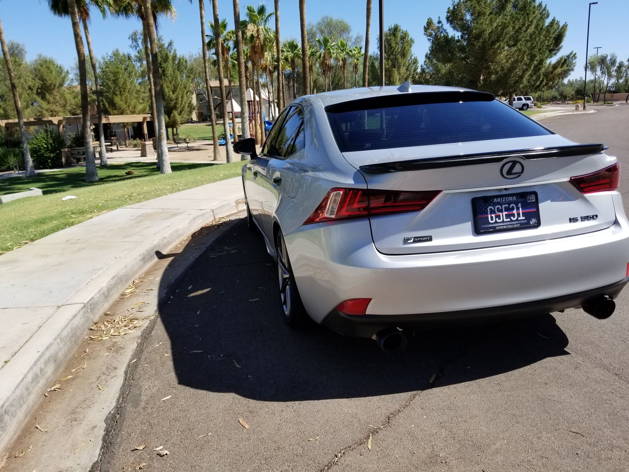

for small parts like you list, heres what wrap looks like. for roof, use good quality wrap? cheap wrap will harden as said and may also leave discolorization (yellow)? does it look cheap?

Got anymore pictures of your car from the rear and rear angles? I've been thinking about getting a lip spoiler and roof spoiler in black on my Atomic Silver

Default Pics per request
for former5FSE:
Passenger rear angle
rear
drivers rear
side
