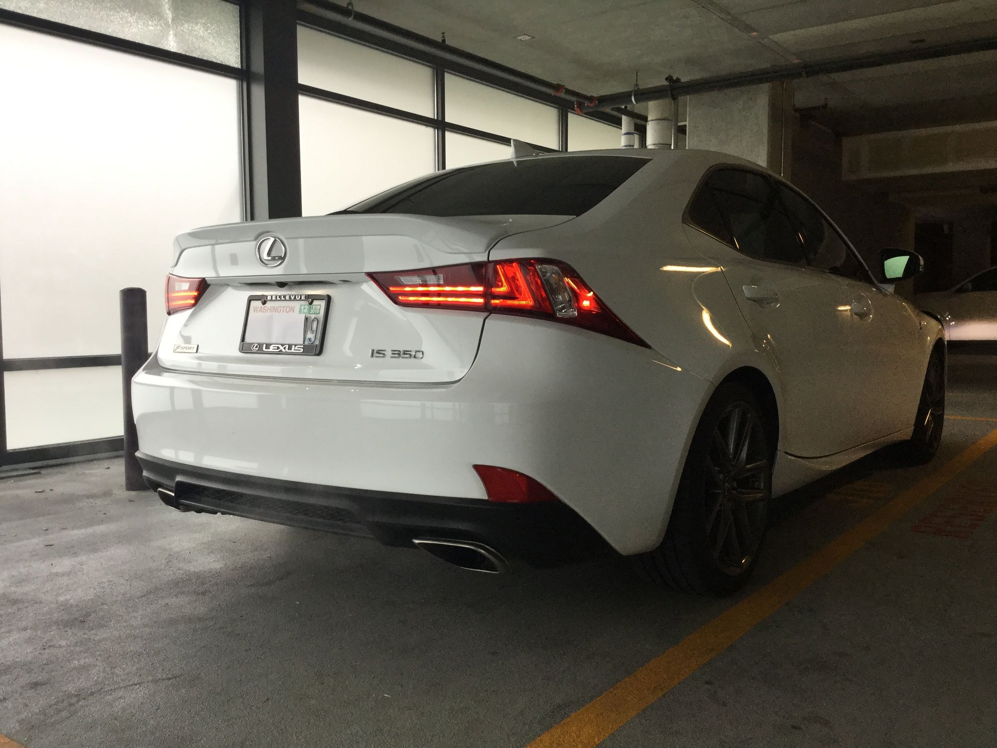

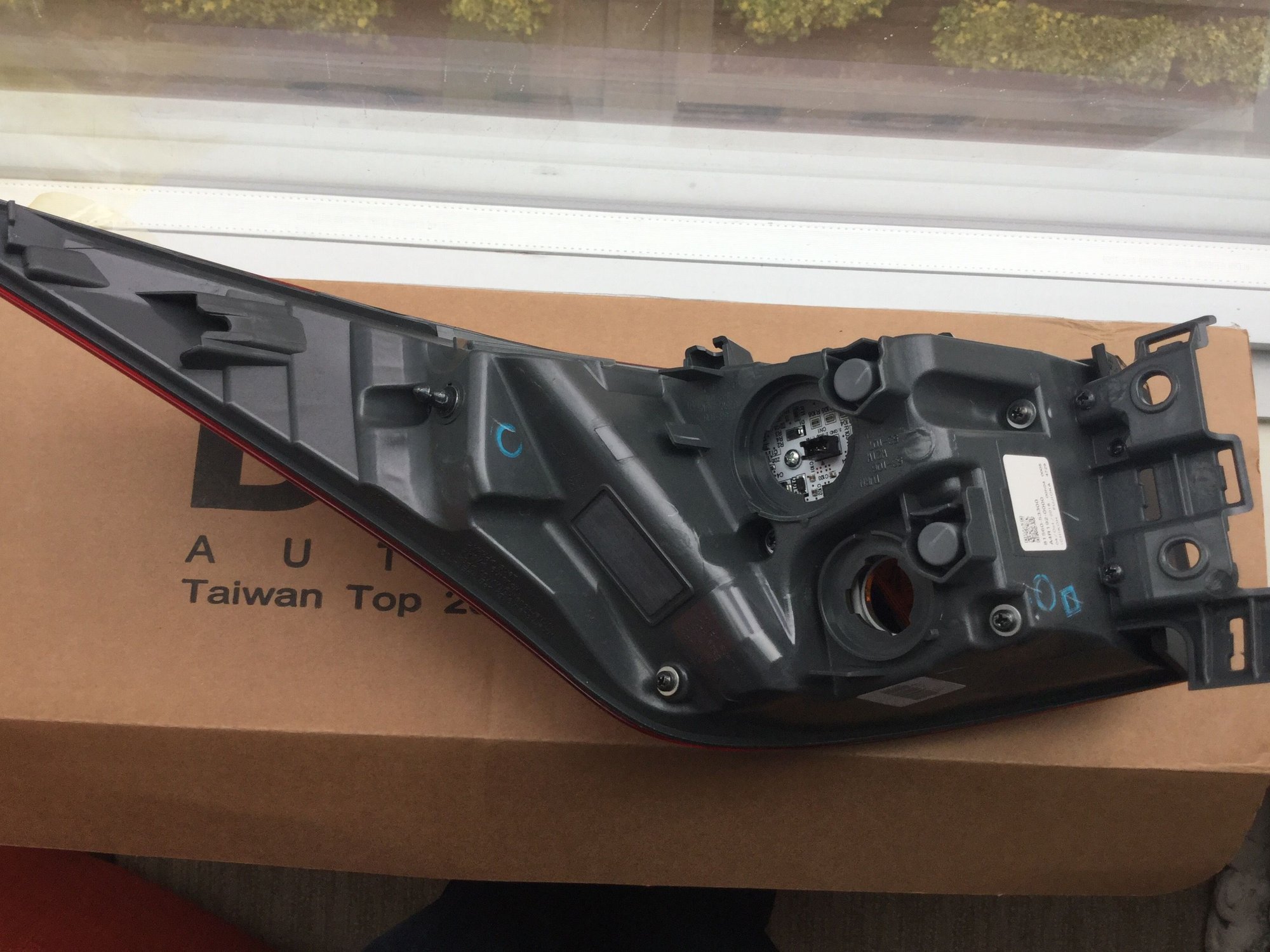

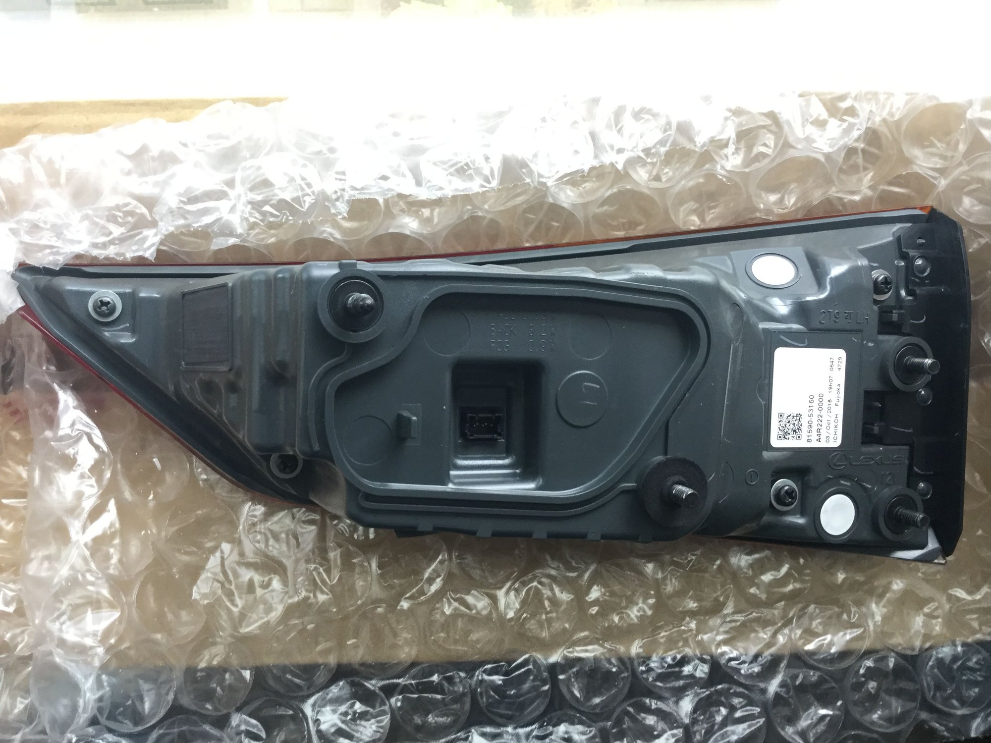

I posted pics of the trunk and tail lights so you guys can see, the trunk lights on the 17 are full LED. There's no bulb but only one LED connector. The 17 tail lights are like the 16, they both have one bulb and one LED connector. Somebody asked earlier, yes the turn signal lon the 17 is bulb, but the bulb itself is clear color with the outside lens orange (only the turn signal section I mean). The 16 is exactly in reverse. The 16 bulb is yellow color and outside lens is red like rest of the lens. Edwin, I'll reply to your PM with the details and yes I'm selling the full set with harnesses etc. Thanks.
Old Mar 4, 2018 | 02:40 PM
TinoPing's Avatar
TinoPing
Joined: Dec 2016
Posts: 127
Here's a couple more pics. Sorry lighting is bit dim. Welcome to Seattle
