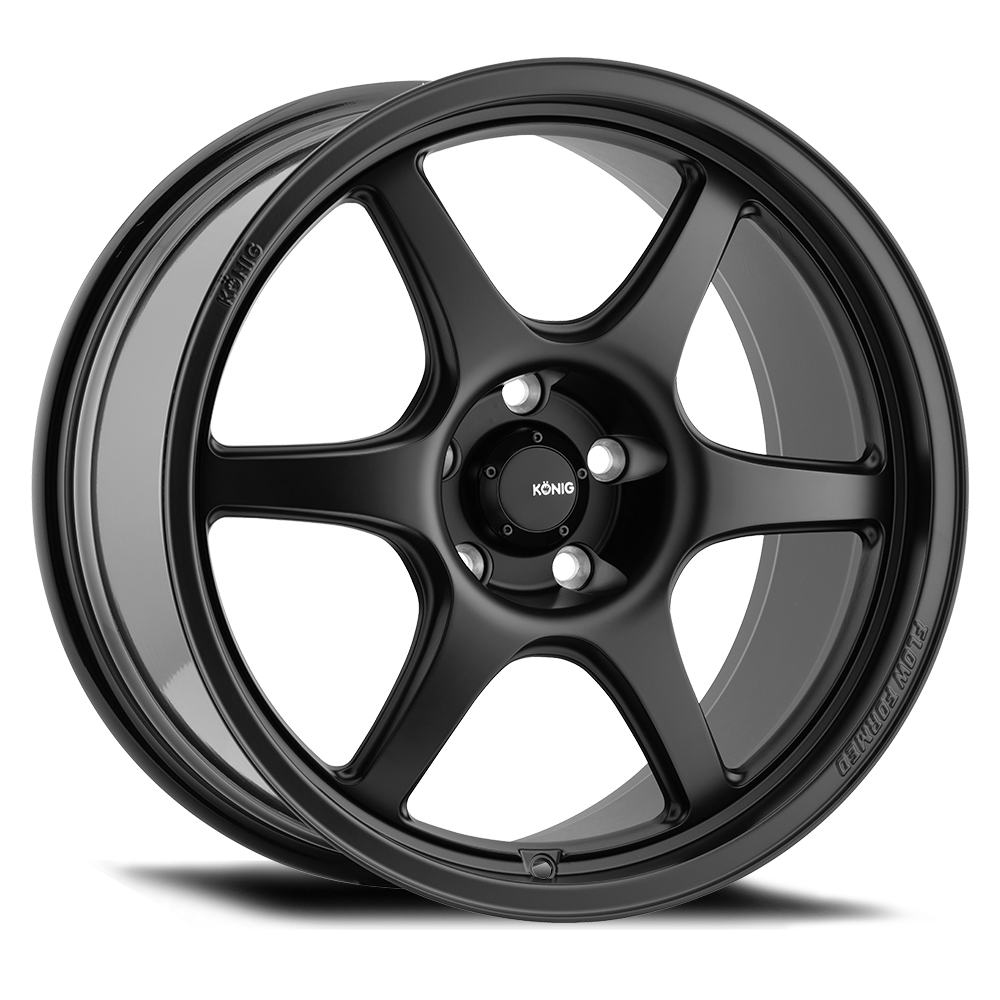

Finally going to start lowering and putting new wheels on my IS200T. Probably going with the specs below. Do you think there will be any issues?
https://konigwheels.com/wheels/flow-...eels/hexaform/
Rear 18x9.5 et 35 255/35
Front 18x8.5 et 35 225/40
Lowered on RSR Downs.
Welcome to the forum!
For the fitment I would suggest a narrow fitting tire, specifically for the rear.
A 9.5 +35 seems to be hit or miss if it rubs on the fender in the rear, so a narrow fitting tire will improve your odds.
All 255/35/18's are not crated equal and some are a little wider than others...i.e. typically Michelins are beefy tires so they will tend to be on the wider side...and you'll find Conti's and Firestones are generally on the narrower side...you would need to check the Tread Width of the tire you want to get.

Thanks for your input!
I'll definitely look into getting some thinner tires. Just found out that I'm going to need to get some spacers for the caliper clearance as well.
