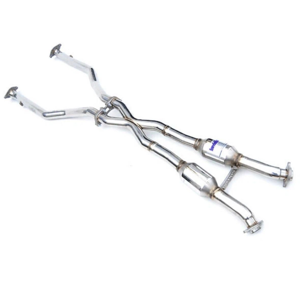

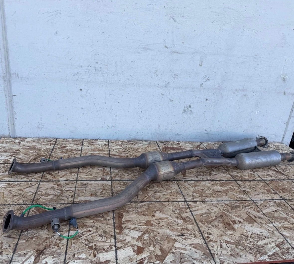

Inside of them cats usually have the catalyst honeycomb insulated with either metal mesh or fiber mat. In the case of Lexus/ Toyota I’m not sure which insulation material they use but in either case the rattle would occur when the honeycomb comes loose or gets damaged over time.
I noticed a difference of the sound when I was inspecting the exhaust. My passenger side cat gives a slight yet noticeably different sound when tapped with a mallet. I can see that would get amplified to a louder rattle at the correct frequency.
Inspection wise, there’s nothing much you can do. Could either drop the whole midpipe section and have a look with a borescope or cut a hole on the cats and see. As you can see in the first image (From an eBay listing) the cats are quite further down the exhaust pipe and there’s a slight bend before that. Hence a borescope would be the only way to see what’s going on. A decent exhaust shop should carry one.
Fixing wise at this point what we can do is:
1. Take both the cats out and get a custom midpipe section welded in.
2. Replace with an OEM mid pipe. With cats I can see the dealer would ask for a small fortune for one.
3. Go for an after market mid pipe replacement like Invidia, Tsudo etc. You could either go full catback (I’m talking about primary ones here) with mufflers or just a midpipe with OEM mufflers.
I’m leaning towards the third option and just getting a midpipe with hi-flow cats and keeping the OEM mufflers. I daily my car and wouldn’t like to deal with any kind of exhaust drone. I understand there’s the risk for a check engine light with an aftermarket exhaust system. If it comes to that will probably have to run some Oxygen sensor spacers with it to get rid of it.
I’m currently in the market for a good midpipe setup and considering all options. Will advise on the progress. Until then I just crank up the music a tad bit.
Image 1:
OEM midpipe section (EBay listing)
Image 2:
Aftermarket midpipe ( Invidia)
Cheers and thanks for reading
