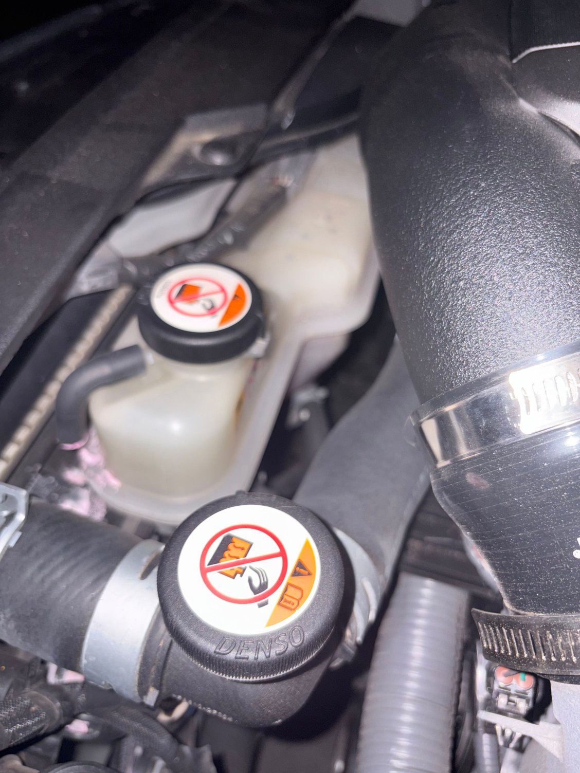

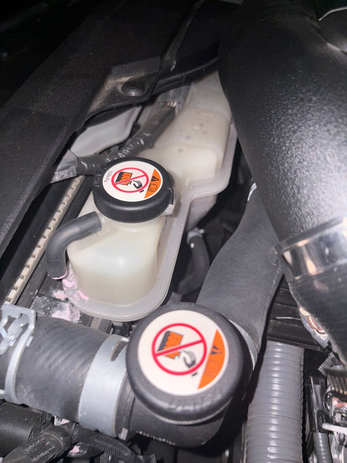

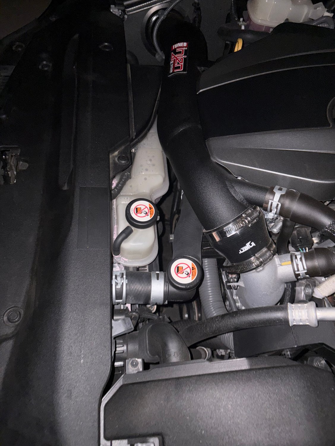

Was looking at my engine bay and I see on of my restivores have no cooltant which I think it takes im I need of help badly to know what this is and what it takes. Also the hose is disconnected as u can see on photo need help badlt

That's just the expansion tank. Fill with Super Long Life coolant (PINK not blue) to the Full line. The hose you show is not disconnected, it's an overflow valve in case the tank is overfilled.

Just like what V350 said.
That container is not supposed to be filled all the way to the top, if that's what you were thinking.
