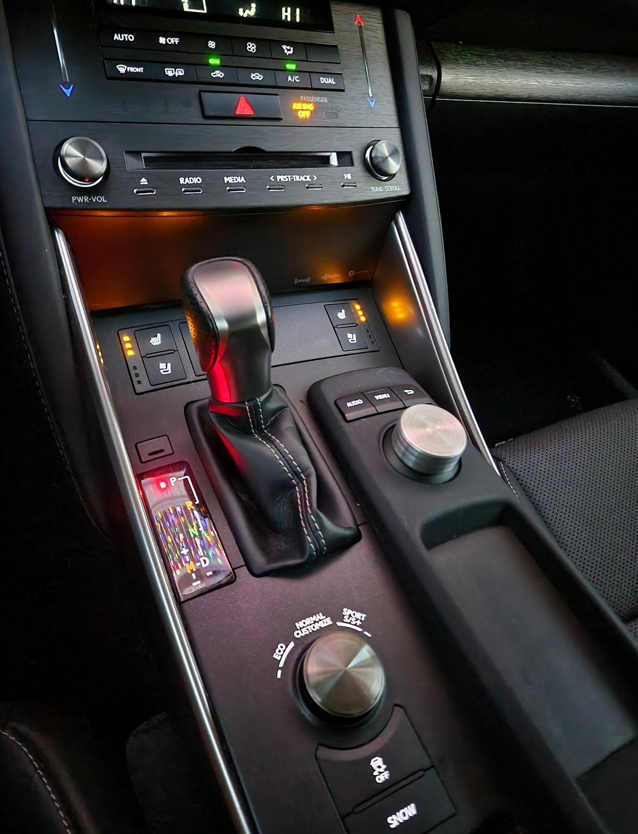

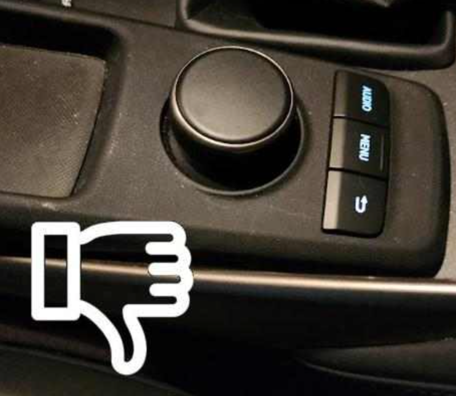

I was unhappy with the plastic infotainment **** being in stark contrast to the premium machined ***** for performance modes, volume and tuning.

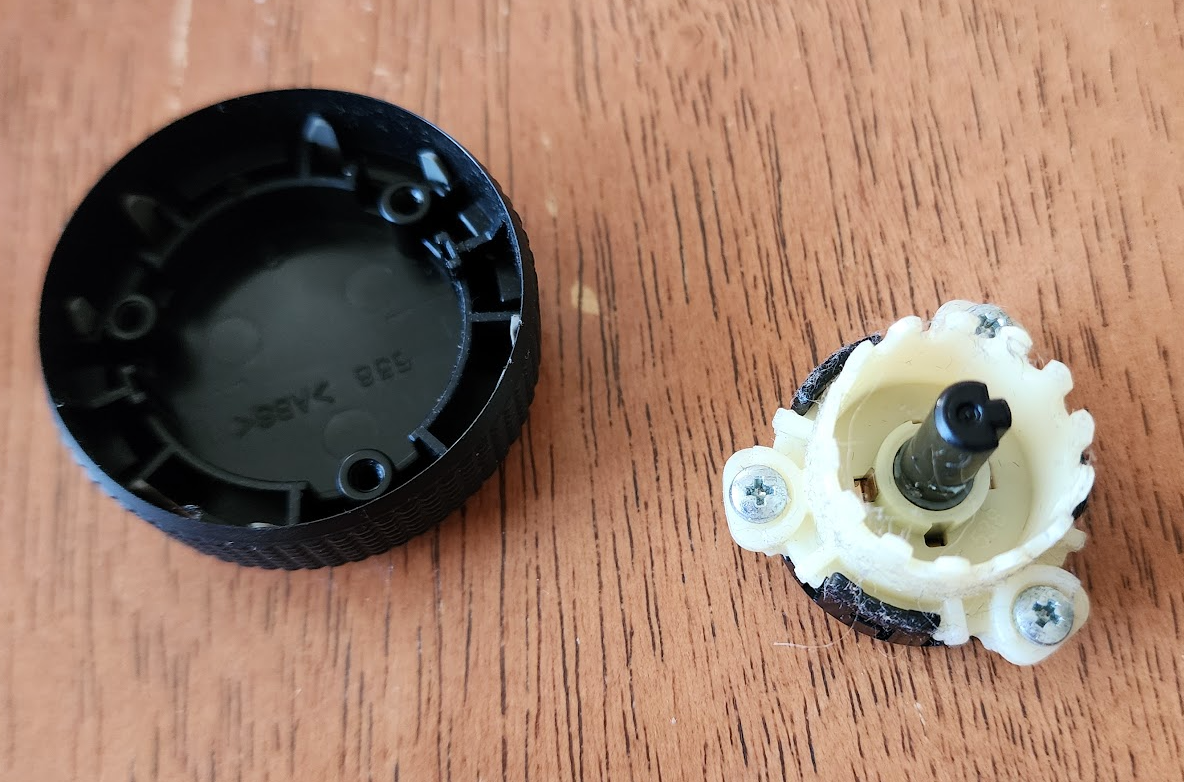

I pulled it off, separating the cylindrical housing and the rotary componentry and very carefully measured it with a caliper.

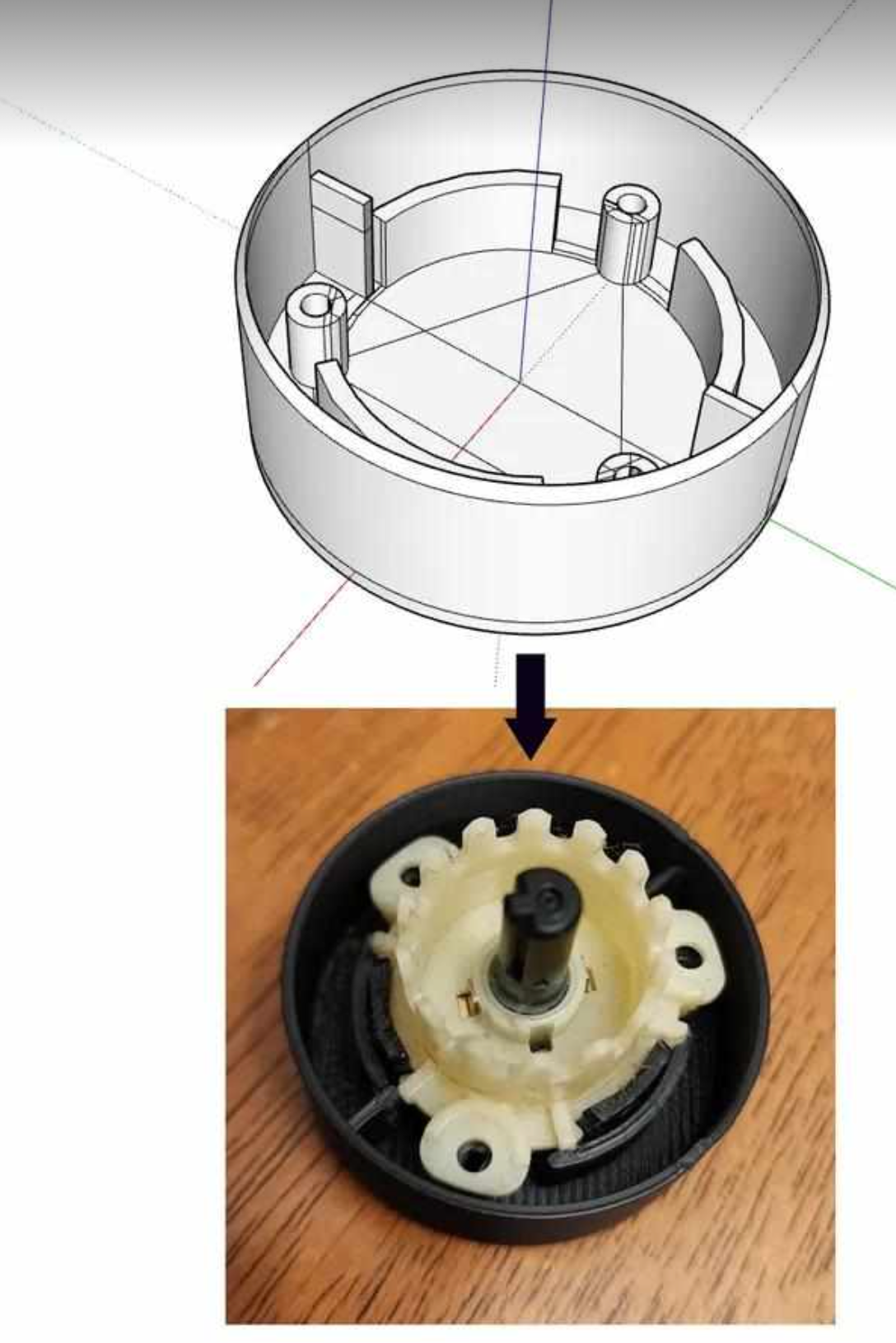

I then created a 3D model in Sketchup and printed a prototype in ASA. Transplanted the rotary component into it to ensure fitment.

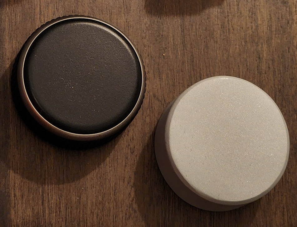

Original vs. one of the two raw aluminium prints.
