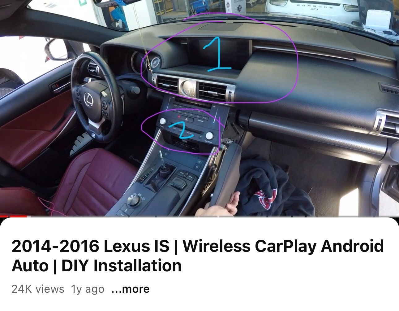

!!!!!! If your radio is doing the reboot loop or just not working at all after experiencing the reboot loop, the issue is not going to be fixed by ordering an aftermarket screen. You have to get the head unit that’s connected to the cd player and controls replaced !!!!!!!

2 needs to be replaced
