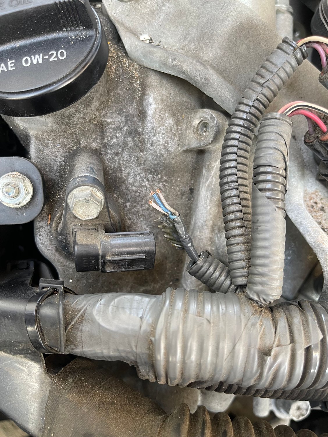

Hello all. I have a 2015 lexus is250 fsport. While getting my alternator replaced i accidently pulled out thr camshaft wires. Now im not sure which order the wires go in. I will attach photos if anyone can help please do and thank you. I’ve been searching all over thr internet but cant seem to find out the issue still

Help bump!
There is no insulation at all inside the connector housing? Thinking no due to evenness of the insulation edge.

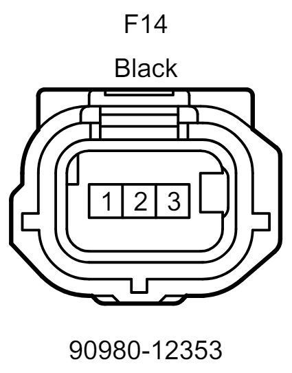

This is Bank 2 Intake VVT Sensor. See pictures below from a wiring diagram; hope it helps!
