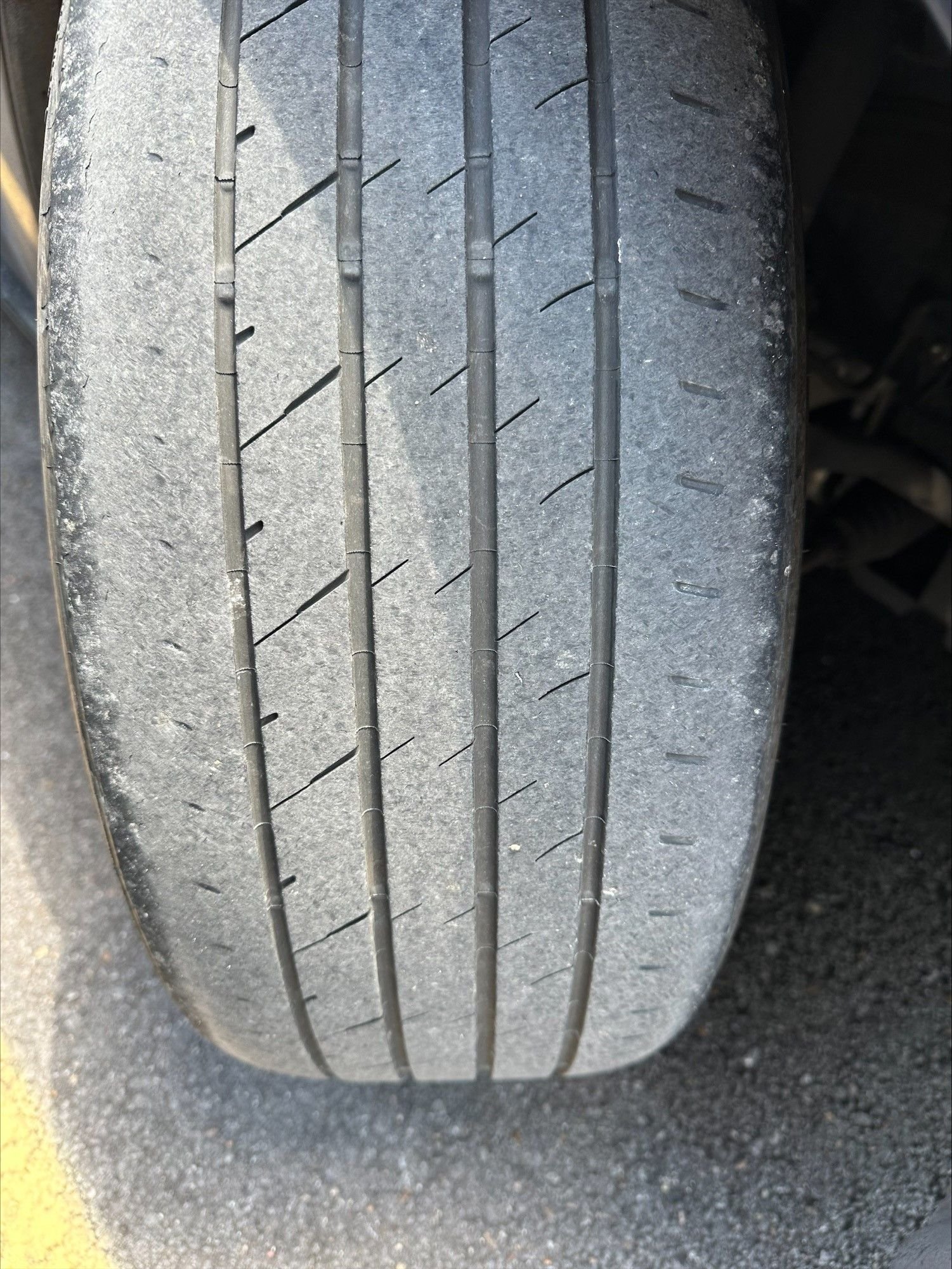

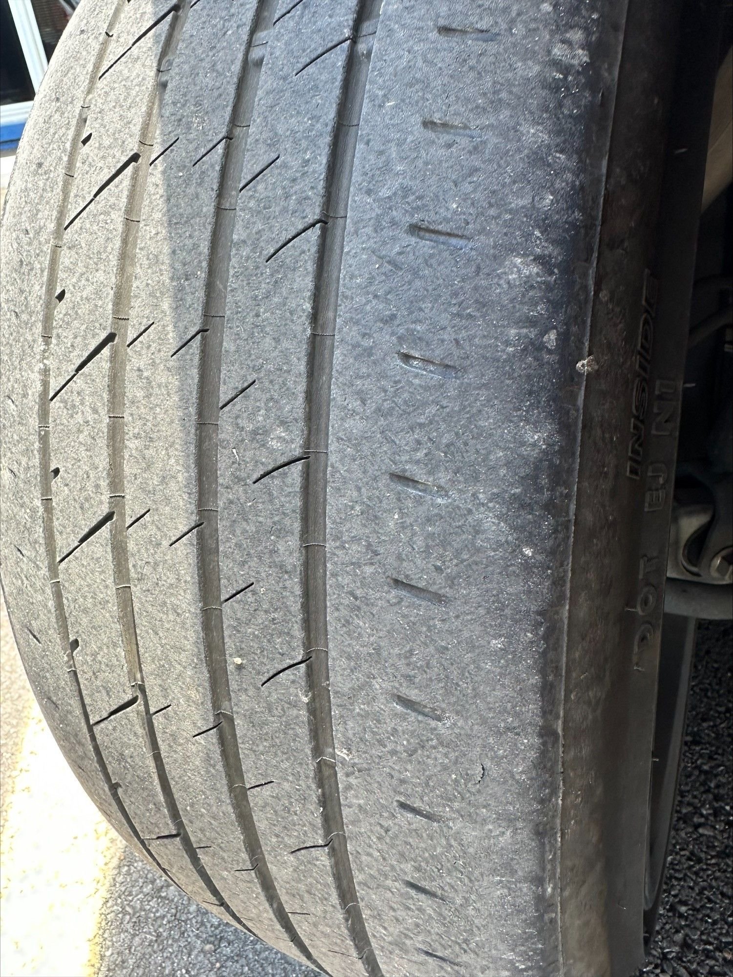

Would this also work if i have inner and outer wear? or do i just need alignment inside thread is fine... has about 20k miles on it and i do sometimes drive the car heavy i have a 22 is350 fsport..
Old May 19, 2023 | 08:08 AM
kj07xk's Avatar
kj07xk
Joined: Jan 2016
Posts: 1,180
Likes: 411
Confusing, you say you have inner and outer wear, but then say the inner is fine. If it’s just outer wear, then try an alignment, sounds like too much toe-in.
Old May 19, 2023 | 08:15 AM
holmanr86's Avatar
holmanr86
7th Gear
Joined: Jan 2020
Posts: 7
SORRY, so what i meant to say is that i have inner wear and outer wear but the thread in the middle is fine, like if i were to keep this tires they would last me another year or so, but sense the inner and outer thread is being used up faster then i will have to get new front tires.. my question was will that RR RACING bushing work to solve this issue or do i just need a alignment..
Old May 19, 2023 | 08:46 AM
DS03's Avatar
DS03
Joined: Jun 2021
Posts: 86
Likes: 31
From: NE OH
Usually an indication of under inflating the tires. Add some air.
Old May 19, 2023 | 09:23 AM
holmanr86's Avatar
holmanr86
7th Gear
Joined: Jan 2020
Posts: 7
My tire meter in my dash tells me all the tires have the same tire pressure, i don't think that's the issue. In my last oil change LEXUS told me i needed two front new tires with a alignment, in my head i thought ( I can still drive with these tires little longer.. )
Old May 19, 2023 | 11:36 AM
kj07xk's Avatar
kj07xk
Joined: Jan 2016
Posts: 1,180
Likes: 411
In that case, get an alignment. Maybe you have excessive toe-in (outer tire wear), and inner wear from the bushings.
Start with the alignment, and see if it’s off. Otherwise, I’d agree with the under inflation comment above. Are you running the same size tires, with the tire pressure as printed on the door placard? If not, you may need to adjust. When I went from 19” wheels to 20” on my other car, I needed to increase the tire pressure up 3 PSI, all around (front and rear PSIs are different on that car).
Old May 19, 2023 | 12:13 PM
holmanr86's Avatar
holmanr86
7th Gear
Joined: Jan 2020
Posts: 7
yes i am running the same oem size tire that came with the car and rim brand new haven't messed with them sense i purchased them and the air is how it should be on PSI, ill move forwards get new tires and get it aligned see if that fixes the issue
