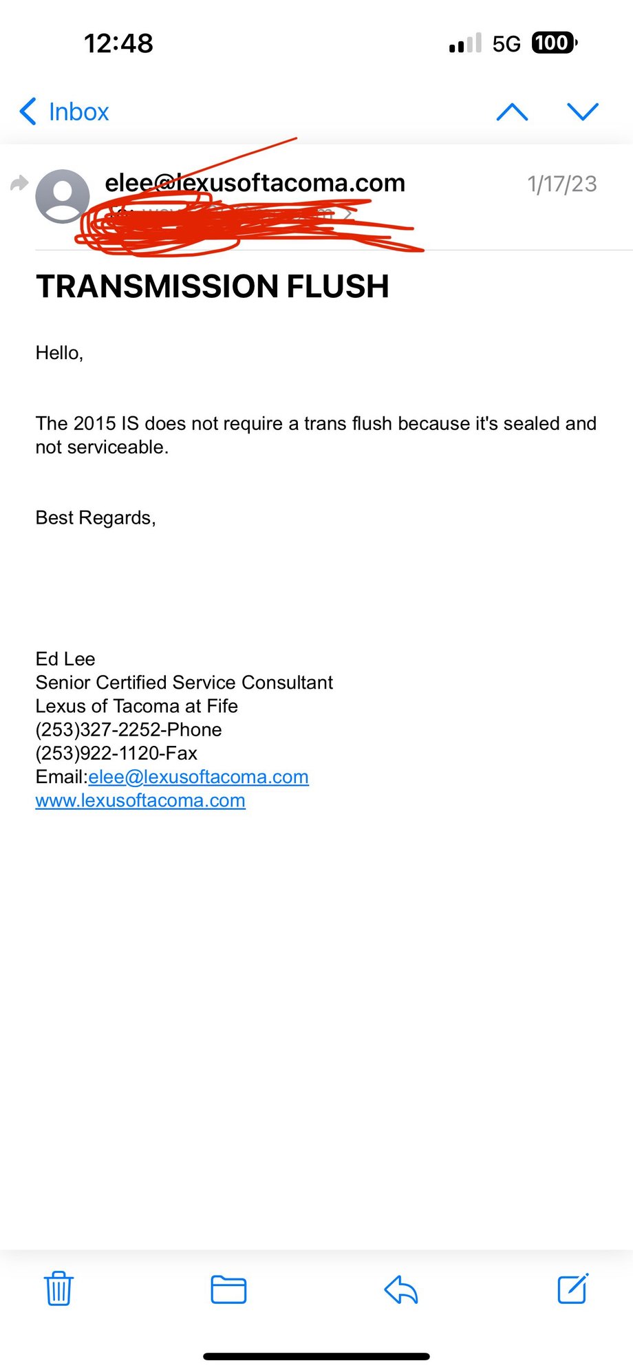

for my 2015 IS250 I’m going to leave and see how long the transmission last without changing the transmission fluids. The reason why I’m doing this to this car is because when I purchase it’s came with a lifetime powertrain warranty. I also contacted the warranty company and ask them they say leave it alone if I tapered with my warranty is void. I also have email from the dealership to back me if my transmission fail have it in writing not to change the transmission fluids. I will be the first to tell when it hits 250k right now it’s on 117k bought the car new with only 54 miles. Stay tuned

Quote: Hopefully it lasts you well beyond 250k!
Let’s see what happen to seal transmission WS, I want to see it for myself really

Apr 29, 2023 | 06:24 PM
Total BS - it is not sealed, and it is designed to be serviced. People can do whatever they want to their own car, and believe whatever they want, but I'm doing a drain / fill at 50k miles (80000 km).
Edit: If it cannot be serviced, then why would there be a drain hole? Why would there be bolts holding the transmission pan in place? These service advisors don't even know any technical details, all they know is how to generate income for the dealership. A transmission job just isn't as profitable as a $200 cabin air filter replacement.
