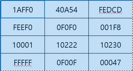

1 Compensation code
https://gearsmagazine.com/magazine/t...-transmission/
you will find this code near Transmission feed hole
here is mine, yours would be different.
2. TechStream.
IF you have a TechStream or cheapyStream whatever works.
Go To Transmission>Utility>A/T compensation code>Set Compensation code
and in put those 0~F Hex code. and done.
