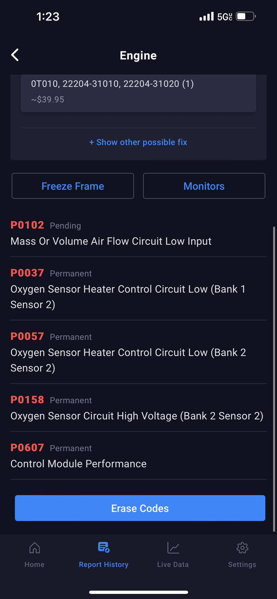

The codes I am getting are p0102, p0037, p0057, p0158, and p0607. I’ve just replaced the MAF and still the same issue.

A MAF code, or any other sensor code, doesn’t mean the sensor is bad and should be replaced. It means that sensor is returning values out of the acceptable range or no output at all.

If the wiring harness was damaged, it will cause issues. Based off the CELs, this is directly a result from the installation of the headers. Since both banks are affected, did you reflash the ECU? What do you mean by "crank no start". A video of you trying to start the car would be beneficial so we can see how exactly the car is "cranking".
