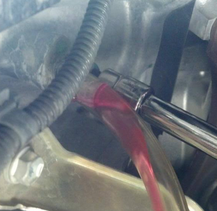

- First remove remover all coolant from overflow reservoir

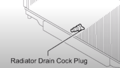

- Loosen the radiator drain plug by turning counter-clockwise and use a 5/16" Inner dimeter hose attached to petcock to assist with draining) (Photo 1)

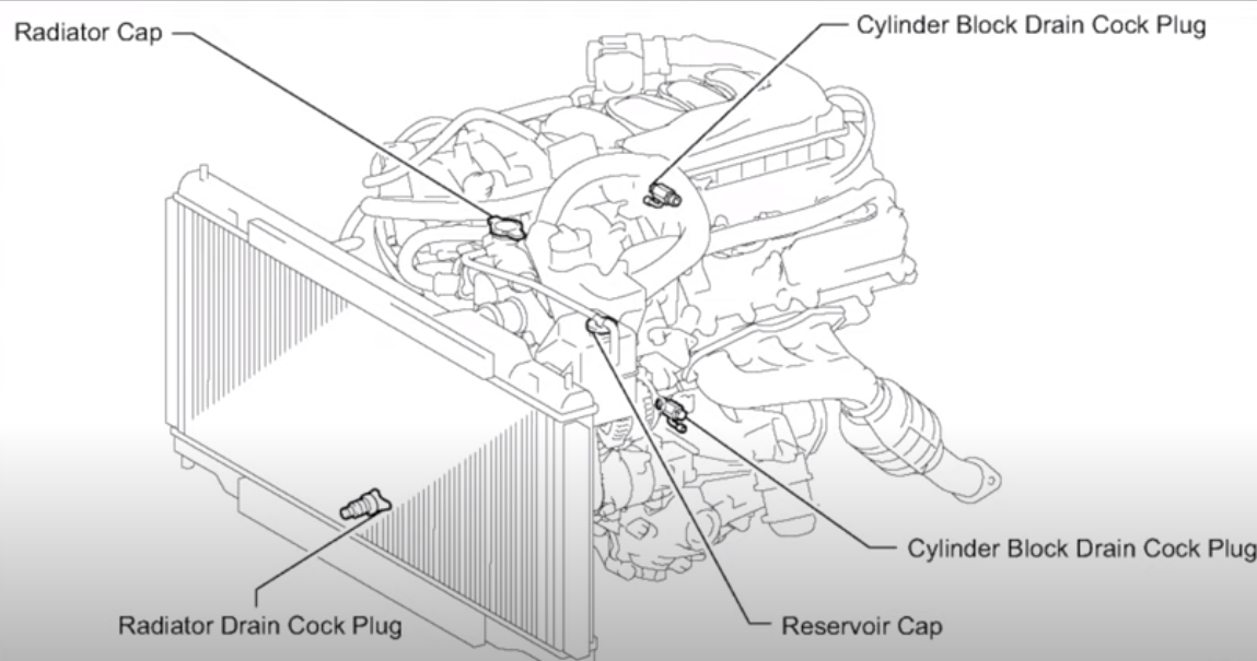

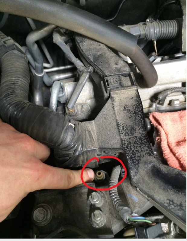

- Where in photo are the plugs located be removed at each cylinder bank shown (Photo 2 )?
- Use a 10 mm wrench / ratchet to loosen the engine block drain plugs shown in diagram and again us a 5/16" Inner dimeter hose attached petcock to assist with draining the fluid . IS THE TOP, BOTTOM OR BOTH ENGINE BLOCK DRAIN PLUGS NEED TO BE OPENED iSHOWN IN DIAGRAM / PHOTO 3C ?

PHOTO 1
PHOTO 2

Agreed, thanks MikeFig82. Will just do a drain and fill with the Toyota 00272-SLLC2 50/50 Pre-Diluted Super Long Life Coolant (no need to use distilled water).

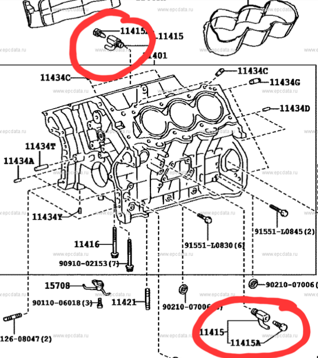

Would like to confirm if both Engine Block drain **** plugs (shown in diagram below), are needed to be accessed / opened to drain the block?

DIAGRAM

DIAGRAM

So the location in red is for the ISX50?
I assume most cars should have a bleeder valve on thermostat housing area, or somewhere in line of the coolant lines.

Also, would like to confirm if both Engine Block drain **** plugs (shown in diagram below), are needed to be accessed / opened to drain the block?
Yes those are the drain plugs. Isn't the coolant system designed for just 2 gallons?

1- Is there a specific process for which of the two engine block drain plugs should be drained first, or it doesn't matter? Is one engine block drain plug used to drain coolant from the top and one from the bottom half of the engine block?
2 - Are engine block drain pugs both located on the same side of the block as shown in previous diagram I had uploaded (driver's side), or is one drain plug located on driver side and one located on passenger side, as it appears in the diagram you uploaded (see below)?
3 - If the 3.5 engine installed in the 2nd Gen IS equipped an air bleeder valve?
There is no specific order to drain. Just choose whatever suits you being the car is cold.
The plugs are as follows facing engine. Driver side cylinder 2 (Bank2) a few inches down under the exhaust pipe.
Passenger side cylinder 5 (Bank 1) a few inches under exhaust manifold. Under the car you should be able to access both sides easily. Probably removing the lower engine cover.
As for a bleeder valve I don't see one on the thermostat outlet housing. Hence it's not mentioned in the drain location diagram.

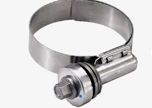

If disconnecting the radiator hoses do not reuse the OEM clamps, or worm style clamps. You want some constant tension clamps. These provide a good 360 degree solid clamp seal without digging into the rubber lines.

Understood and thanks again Mike! I appreciate the additional information on location the engine bloc drain / air purge plugs. I recall you previous suggesting to use constant torque hose clamps in place of the OEM if removed;
Gates Constant Tension Hose Clamp 3270 Green Stripe shown (Clamping diameters – GSCT 9/16" to 3-1/2" and GSHD 1" to 9-1/8".)

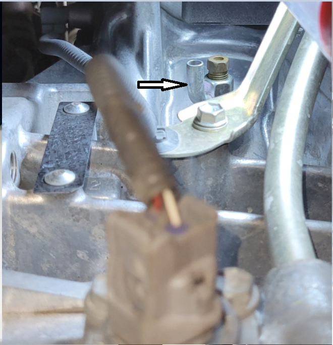

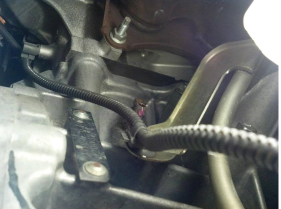

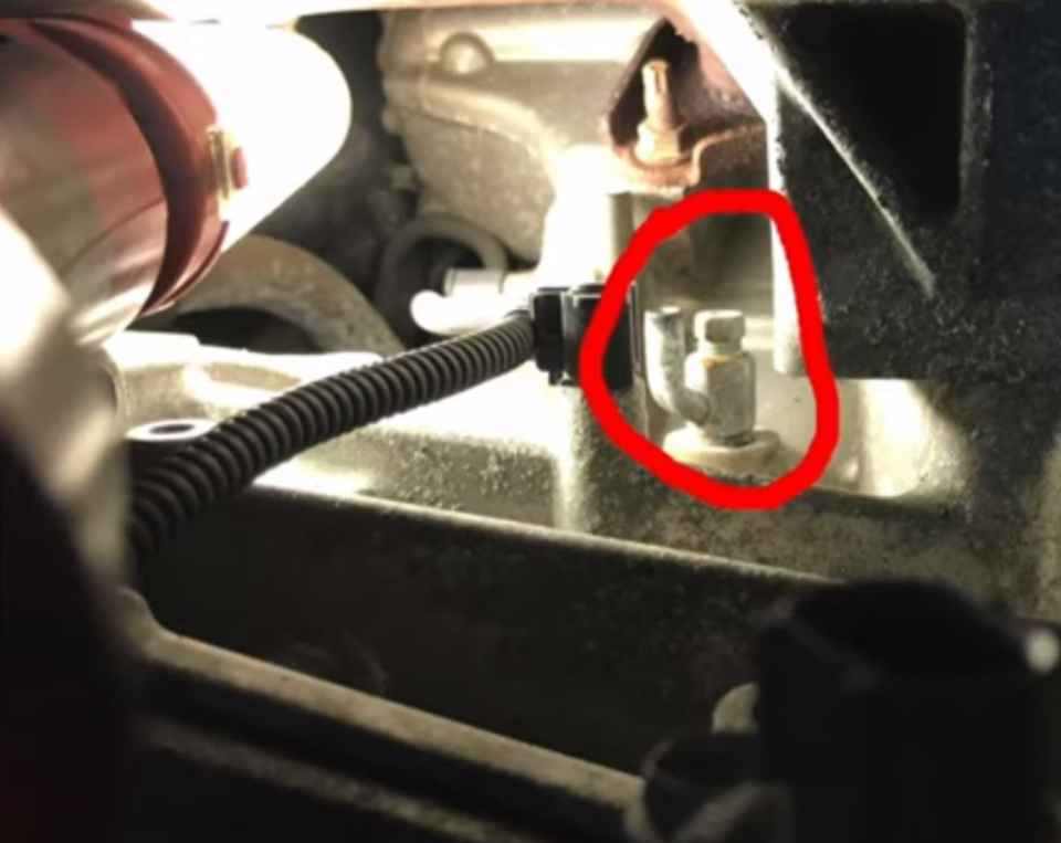

Mike, completed a preliminary survey of what will be involved with performing the coolant flush. Was able to locate the Engine block drain plug on the passenger side of vehicle located just below the exhaust manifold, as you had previously stated (see photos below). Was able to access it by removing the underbody trim panel fastened in place with four 10mm screws (adjacent to the black oil pan). Confirmed that a 5/16" ID (Inner Diameter) hose can be placed over the drain valve providing a tight fit.
I was unable to locate the Engine block drain plug located on the Driver side. Mike, can the drain plug on the Driver side be accessed from above / under the hood, and removing the engine trim near the Master Cylinder reservoir?
Also confirmed that the same 5/16" ID hose can also be placed over the radiator drain petcock. Was able to access it by removing the underbody trim panel used to access the oil filter (fastened by three 10imm screws).
Driver side is right under the manifold cylinder 2. I would say about an inch on the lower part inline of the alternator. I'm sure if you remove the wheel you should be able to see it.

Thank you! Will again check near cylinder 2, in the area surrounding the alternator.
Old Jul 20, 2022 | 03:38 AM
ELexis's Avatar
ELexis
Joined: Dec 2019
Posts: 946
Likes: 150
From: State

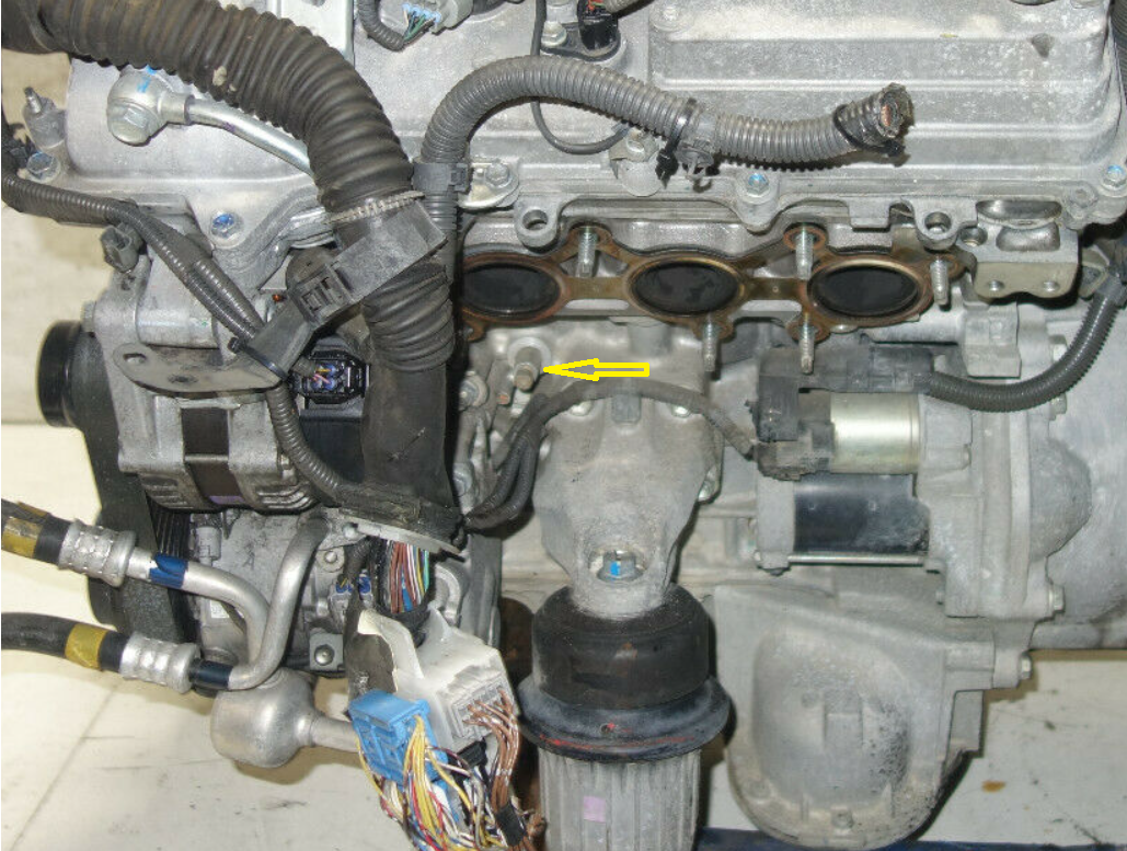

Believe I located the Driver side engine block coolant plug, on the following engine that was removed (referenced by yellow arrow).. Now, just need to access it!!
