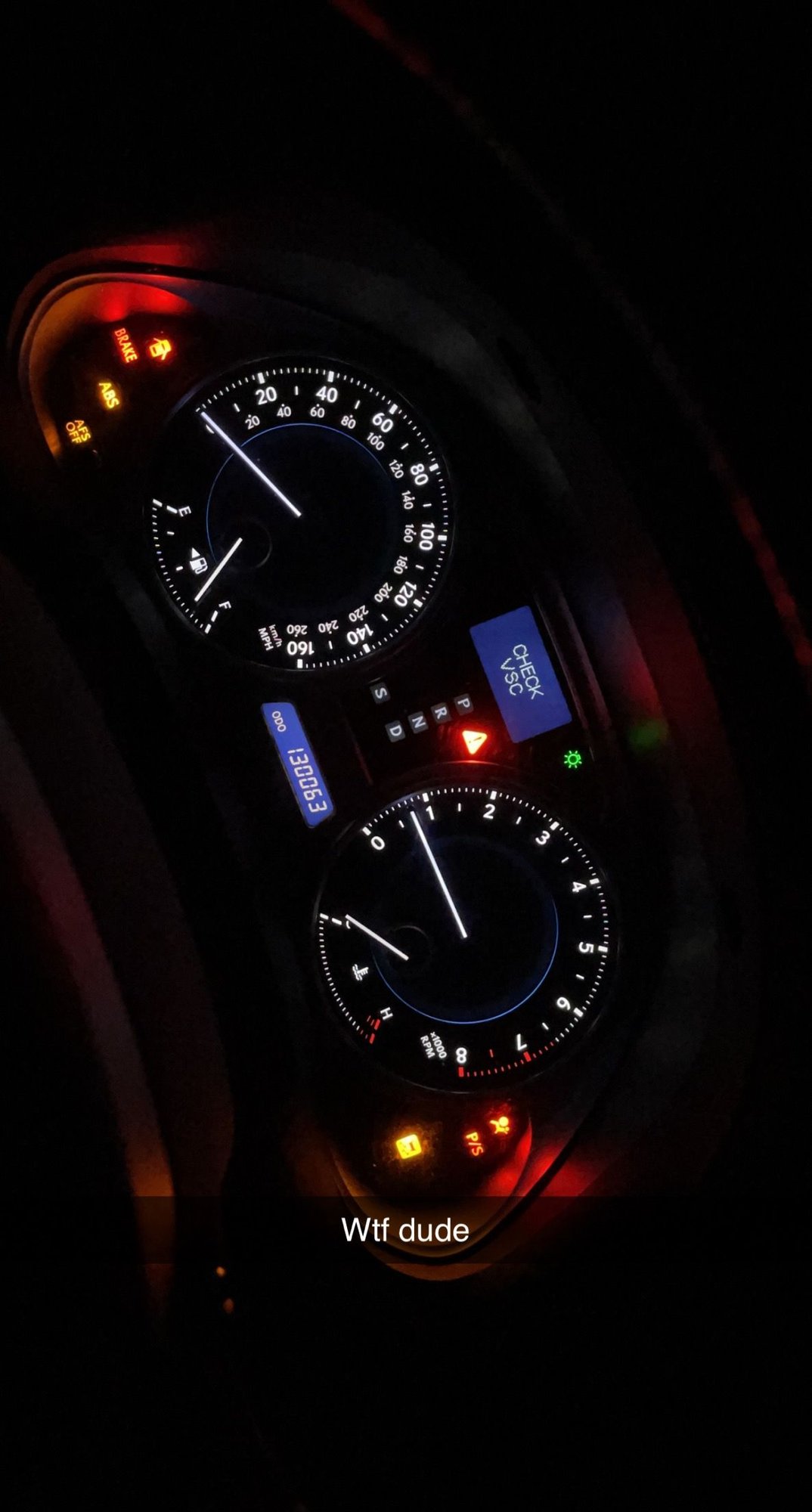

Pretty much every warning light comes on, but they don’t come on when I initially start the car. The lights don’t come on until I drive it for 5-10 minutes

You possibly have a wheel speed sensor that is going bad.

that would be causing that??????

Bad wheel speed sensor, often they are damaging during suspension and brake work. Keep in mind I'm guessing you need to hook up a code reader.

I’m gonna go do that tomorrow but thanks for the info, this is my first Lexus

You will need a scan tool with ABS capability for VSC. The standard scan tools will only read the engine codes.
