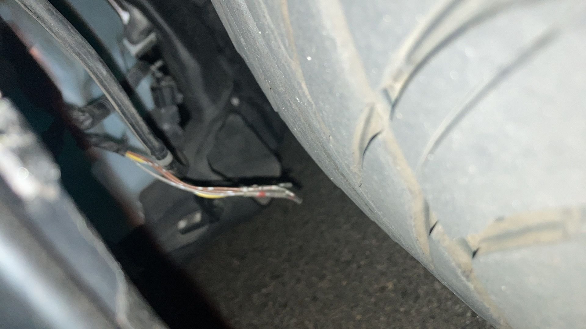

Ripped wiring I have a 2007 is250 a/t 2wd my fender liner ripped out and shortly after I noticed these wires ripped and later got code p0713 I have a feeling they’re related. a/t Tft reading -40.
It’s two brown a yellow and a grey I have concerns they go to the ecu above them the wires are hanging by washer fluid reservoir and fog lights also thanks in advance to anyone who can help I hope this doesn’t turn into something extensive

P0713 is a code for a voltage problem with the automatic transmission temperature sensor
TCM is reading voltage that is too high

Find the other end and splice them back together. Suggest bare crimps and shrink tubing.

That’s just the thing! I’ve searched high and low for the other end and even taken apart the fender area and grille I can’t find out what the hell it goes to that’s why I’m asking for help. If perhaps someone can show me their wiring in that area or let me know what is on the other end and where it’s located that would be so greatly appreciated. Or if these wires control something important I just really would like to figure it out :/ I’ve also looked at some wiring diagrams and ecu pin out but can’t figure out which wires these are as I cannot find any other end. I’m wondering if perhaps they were pinned directly into the ecu junction box and ripped out meaning there is no other end and they will have to be routed back into the box
thanks
