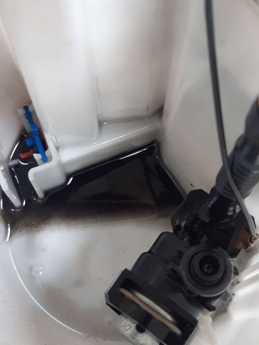

Default Fuel Filter change
Hi, so I took out my fuel pump and changed the filter with a Ryco one, waiting for lockdown to finish to get grinder locked at work so can cut this filter in half and post it here, it's black as ***** inside. With fuel tank on empty, towels all around, makes it easier, tip all your fuel in pump back into tank before you take it where you need to work it. I didn't buy the Ebay one, which now absolutely recommend it because getting to one bottom connector of the fuel filter was annoying. But take a look at this, lifetime filter, this is what was collecting at the bottom of the pump near a filter piece 23217-31100 which is now on its way so second removal will be necessary. grrrrrr.
Lifetime filter, tasty. Put that in your engine, it's already going in anyway. Nothing wrong.
