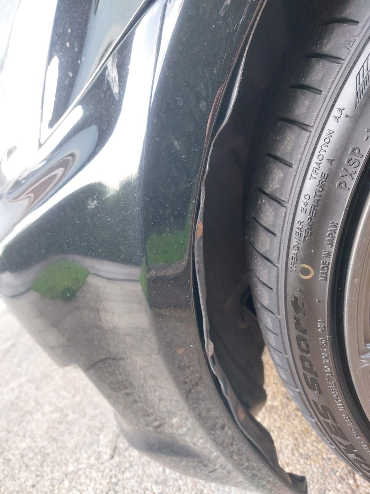

By the way, could you guys with the 2011 and new cars or with the 2011 bumper do be a big favor? Does my fender line look to be a 2011 facelift one? The fender liners currently on my car don't seem to fit. You can see them from the outside. I'm thinking they are just not the correct ones. Maybe the former owner bought new ones and instead of buying the right one, he bought liners for the IS facelift 2011. The liners have holes which don't align with any hole on the fender. OhioIS350 mentioned the holes on the pre-facelift liners not aligning with the facelift 2011 bumper. So maybe my liners are 2011. For all I know the screws on the liners are there because new holes were made on the liners to align with the holes on the fenders. As I don't think there are supposed to be any empty holes, right? So maybe they are for the 2011 facelift cars and I won't need to buy new liners when I put on the facelift bumper on my car.
Here you can see the empty holes and that they don't align with any holes on the fender:
Thanks a lot guys!

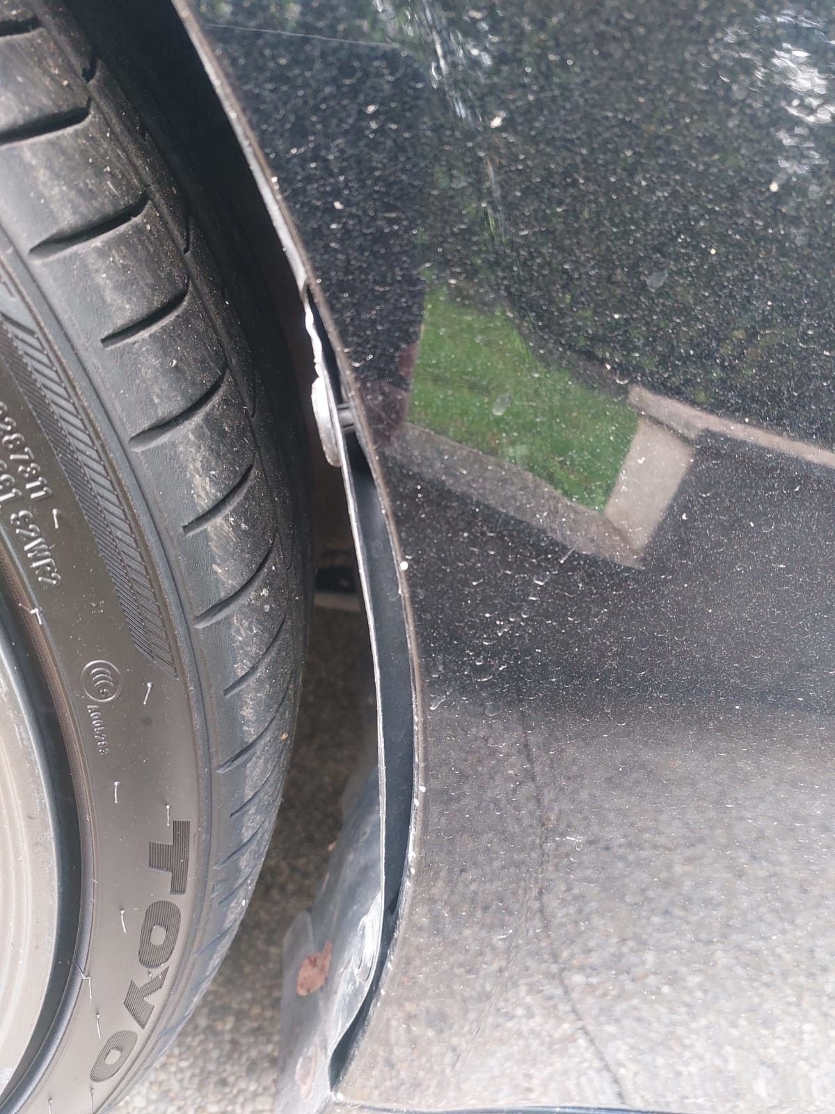

Here's how they look, from another angle. Just don't look right.

i think those liners are aftermarket one, that why it’s look like wavy and uneven look? They mounted wrong too, the fender liners supposed to tucked behind the fender not outside the fenders the 06”-09” fender liners can tuck inside behind the 11” bumper without the bumper fender clips if you don’t want to. But you can reuse your fender liners on the new bumper, but make sure the liners tuck behind the bumper

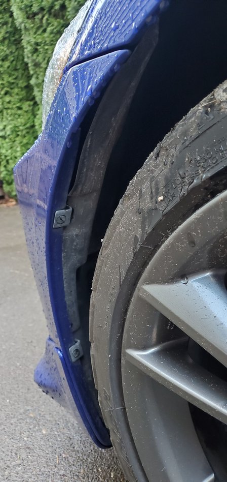

Here ya go...
First rain in months and my skinned rim... I did that one! =/
Ah that makes sense. I guess this explain why it looks so ugly and out of place. No idea why it is not tucked behind. But how would the fender liners hold without the bumper fender clips? So yours is without the bumper fender clips?

Thanks a lot for taking the time to make the photos. Truly appreciate it.
It seems besides not being tucked behind, my fender liners are also using the wrong clips/fasteners. They look more like bolts where yours look like clips. Unless this is different between 2006 and 2011? I will look for the part numbers of the clips as I probably need to order them too. So far I couldn't find them here: https://www.discountpartsmonster.com...and-components
