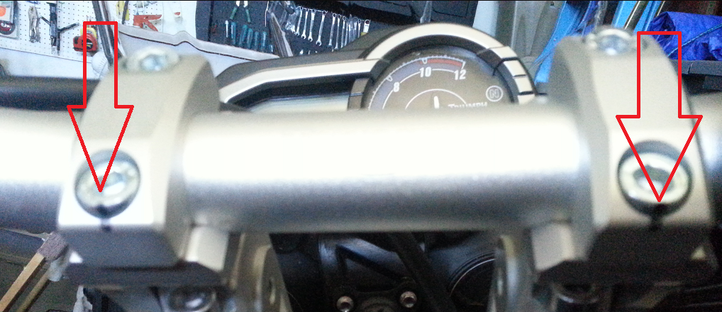

You'll likely see that the seat bolts have Sharpie marks on them. I would take note of the position of the Sharpie marks and make sure that when you tighten down the seat, that the Sharpie mark is back in the same, original location. The marks are placed there in the factory and it allows one to quickly determine if the seat bolts have come loose over ownership of the car.
Here's an example of what I'm talking about. It's not a car seat but marking critical fasteners is common:
