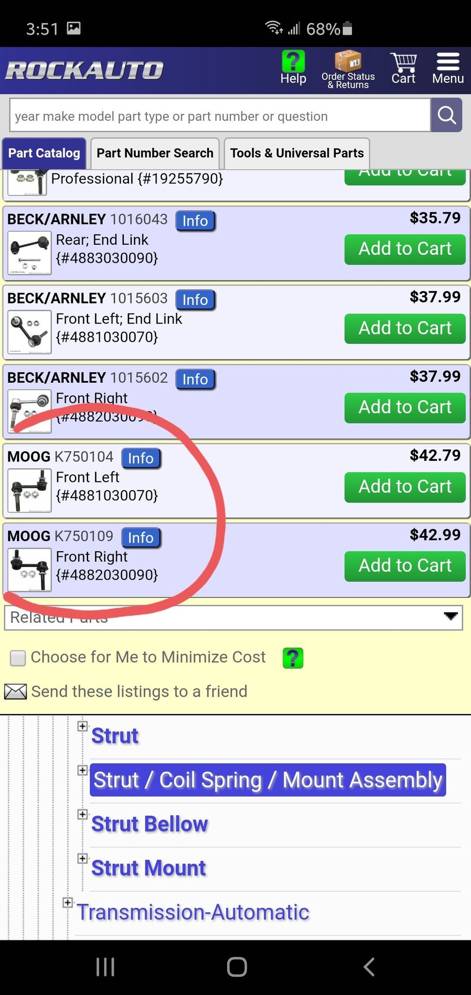

Old Jul 8, 2020 | 02:29 PM
  #39
AMIRZA786's Avatar
AMIRZA786
Posts: 19,716
Likes: 3,768
Originally Posted by MikeFig82
Those are exactly what I have, same part numbers. They don't fit. I don't know if the parts are mislabeled or defective. We were able to get the drivers side on with a lot of difficulty, but not the passenger side at all. The stock End links come off and on easily. This is what an experienced mechanic who has done hundreds of these installs told me

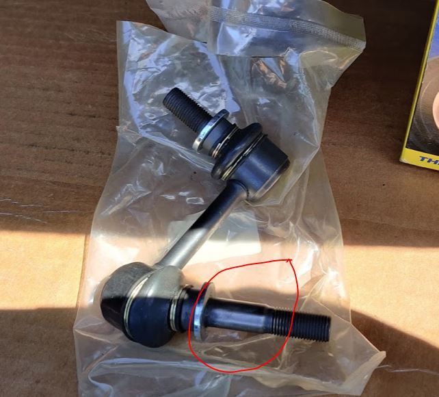

So did you ever compare them or see exactly what the issue was? A small burr inside the sway bar end could easily prevent the stud end of the joint from entering. You know, the old "hole is too tight issue", but if its turned 90° out of phase from the OEM, that's a form fit function issue (FFF).
I'm just curious what the actual problem was. Thx
Old Jul 9, 2020 | 10:44 AM
  #44
AMIRZA786's Avatar
AMIRZA786
Posts: 19,716
Likes: 3,768
There were two issues:
The first was the part of the stud that is circled was too thick, so he could not get it through the Sway bar end:
The second issue was that the nuts that came with End Links would not fully thread on the studs without using an impact gun, which would strip the threads
As I mentioned earlier, my mechanic is very experienced and has done hundreds of these. If a part doesn't fit properly, he won't modify it to fit. He also told me that he has installed lots of components from MOOG, and he believes that these are just generic repackaged parts and are not actually a MOOG product. There was nothing on the End Link stamped 'MOOG". Anyway the OEM End Links from Lexus worked perfectly, now there is absolutely no rattling or noise. I drove this morning on a rough road, and absolutely no excess noise or rattles
