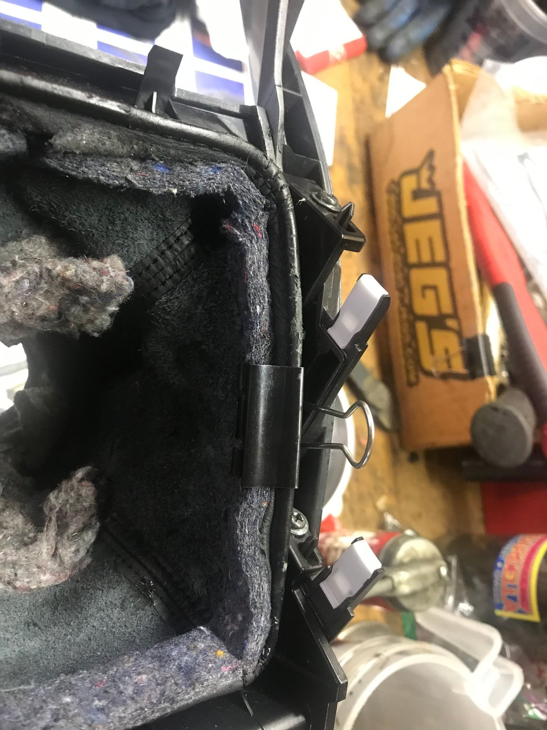

An update for you, I pulled the console and found that the tabs which hold the shift boot in place were broke on the driver's side. Solution? A binder clip!

I just recently purchased an is250 and the boot keeps popping out. The driver side tab is broken as well, did this binder clip permanently fix this issue? And how exactly is this clipped? Thanks in advance.
