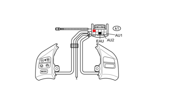

Does anyone have the pin details for the steering wheel switches? I believe each side switch has 6 pins. Does anyone know if there are pins dedicated to illumination?

LED pins are highlighted in illustration below. Red square is +LED and black sqaure is -LED
