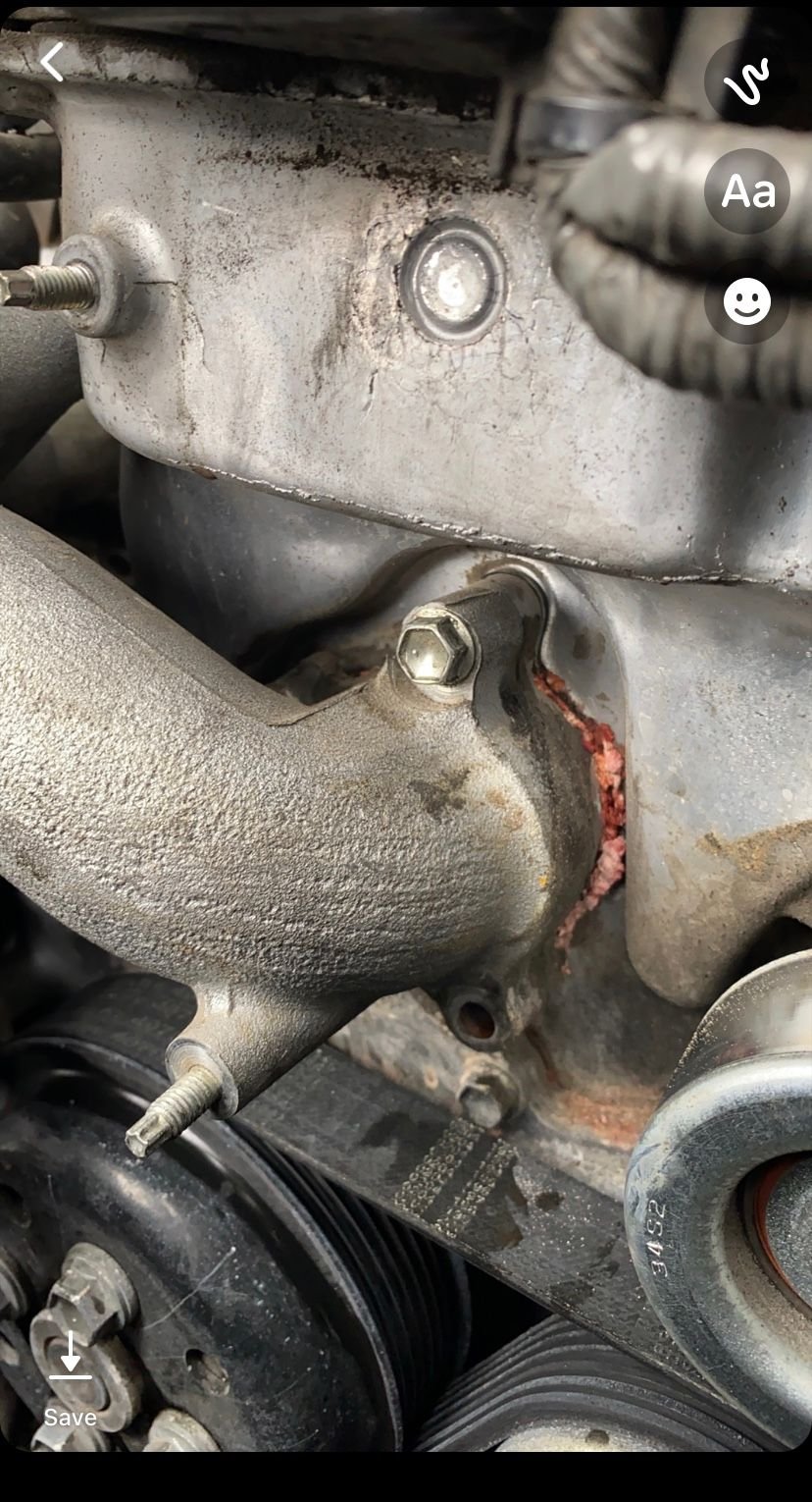

Does anyone know what kind of Gasket/part is this? For lexus is250 06. Thanks in Advance!
Does anyone know what kind of Gasket/part is this? For lexus is250 06 thanks in advance!

If I'm looking at this correctly. It should be list #16325.
You'll probably want to replace #16306A as well.

Thank you sooo much!!

^I hope you know you're missing a bolt there!

I do :/ and unfortunately theres a broken bolt stuck inside(i recently just got the car and its already like that). Any suggestion what to do with it?

Can you see what's left of the actual scew? You may have enough to get some vise grips to bite good.

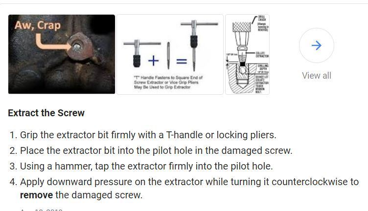

You will need to buy a bolt extractor
I once many, many years ago tried to use a drill on a broken bolt, and let's just say that was the wrong thing to do. I can't stress how wrong
Even those require a hole drilled.
Tips:
Soak the offending bolt with penetrating oil!!! Days in advance!
If nothing protrudes out, i.e. not enough to grab; get a grinder and grind the nub flat. Now center punch it dead smack in the middle.
Install a long stud in an adjacent hole to act as a visual guide. Visual cues of drilling straight are VERY HELPFUL!!!
Drill a pilot hole undersize from your extractor. Now using a left hand bit (they cut while turning counterclockwise) start drilling using your guide. If get lucky, the left hand bit will bite and spin out the broken bolt.
