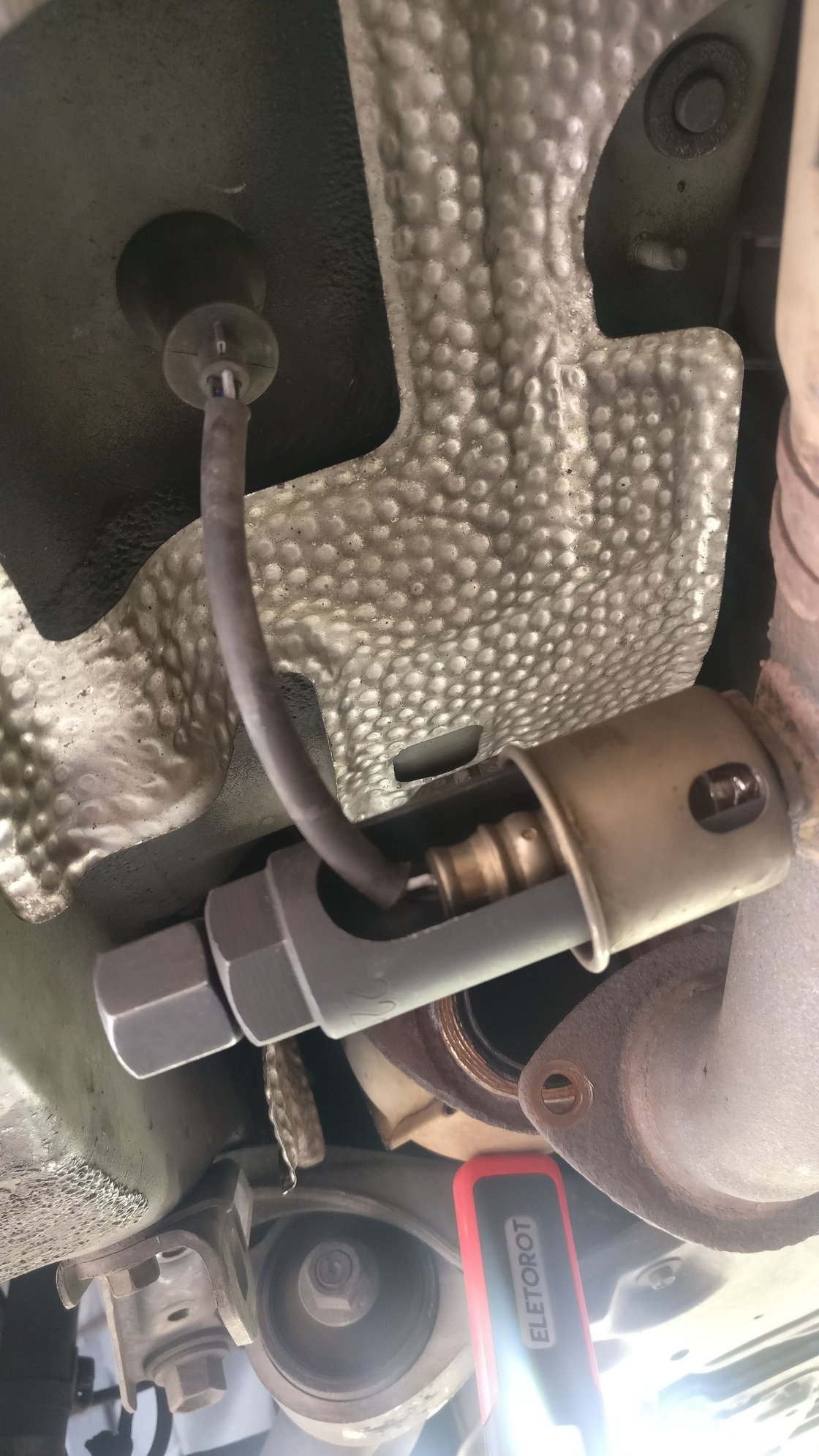

I'm trying to replace my mid pipe which means I need to remove the downstream O2 sensor from the old pipes.
I've managed to lose both of them from the pipe. However, when using the removal tool, I'm twisiting the cable.
This may be an obvious, but would I really need to disconnect the O2 sensor from inside the car to prevent the wire from twisiting when removing?
I really don't want to be removing panels and lifting carpets 😩
Removal tool will twist and damage cable unless I somehow disconnect from other end??

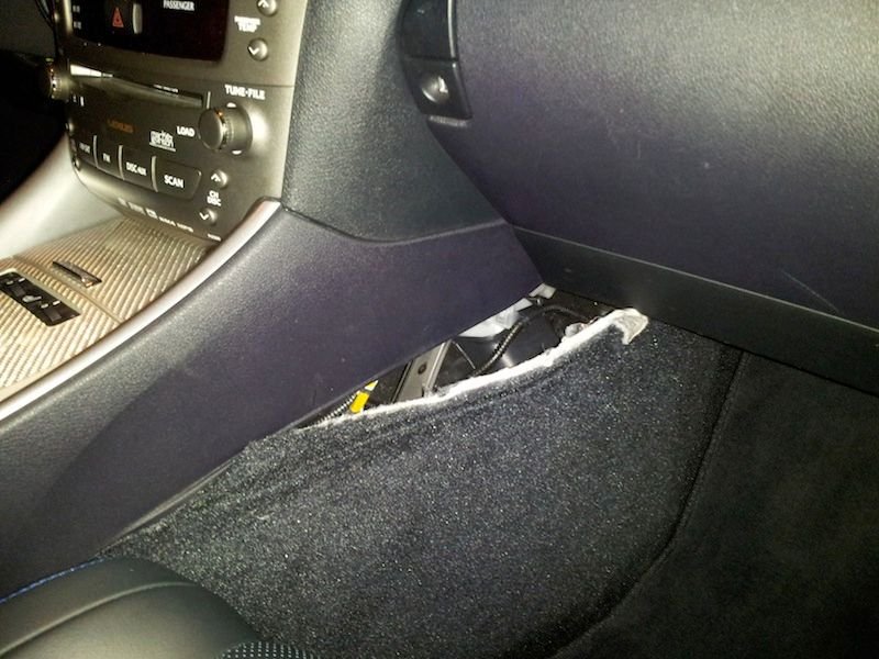

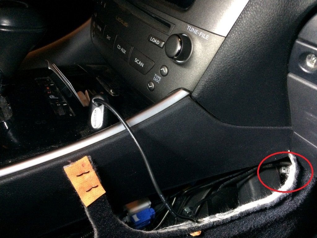

No need to remove panels, move the seat back, pull the carpet on one side just enough to unplug the connector. The carpet is pretty thick in the floor area, I suggest stuffing a tennis ball under the carpet where the sensor goes through the floor hole to give you extra room. Disconnect it, push the rubber grommet or pull it gently from under the car, undo the O2 sensor from the pipe.

Personally, I'd just pull the black rubber boot/seal from the floorboard and remove the O2 sensor. Not enough or long enough threads for one to worry about twisting the wires to a point of breaking them when removing the sensor. I've done this a couple of times actually.
