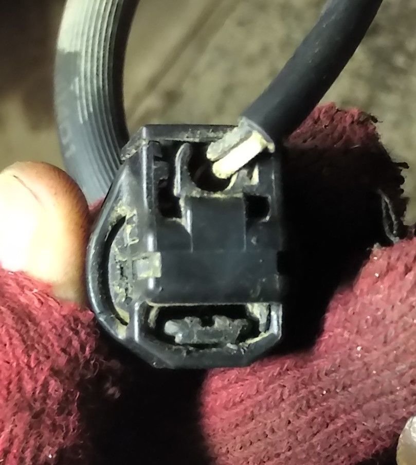

Here's a better pic of the harness

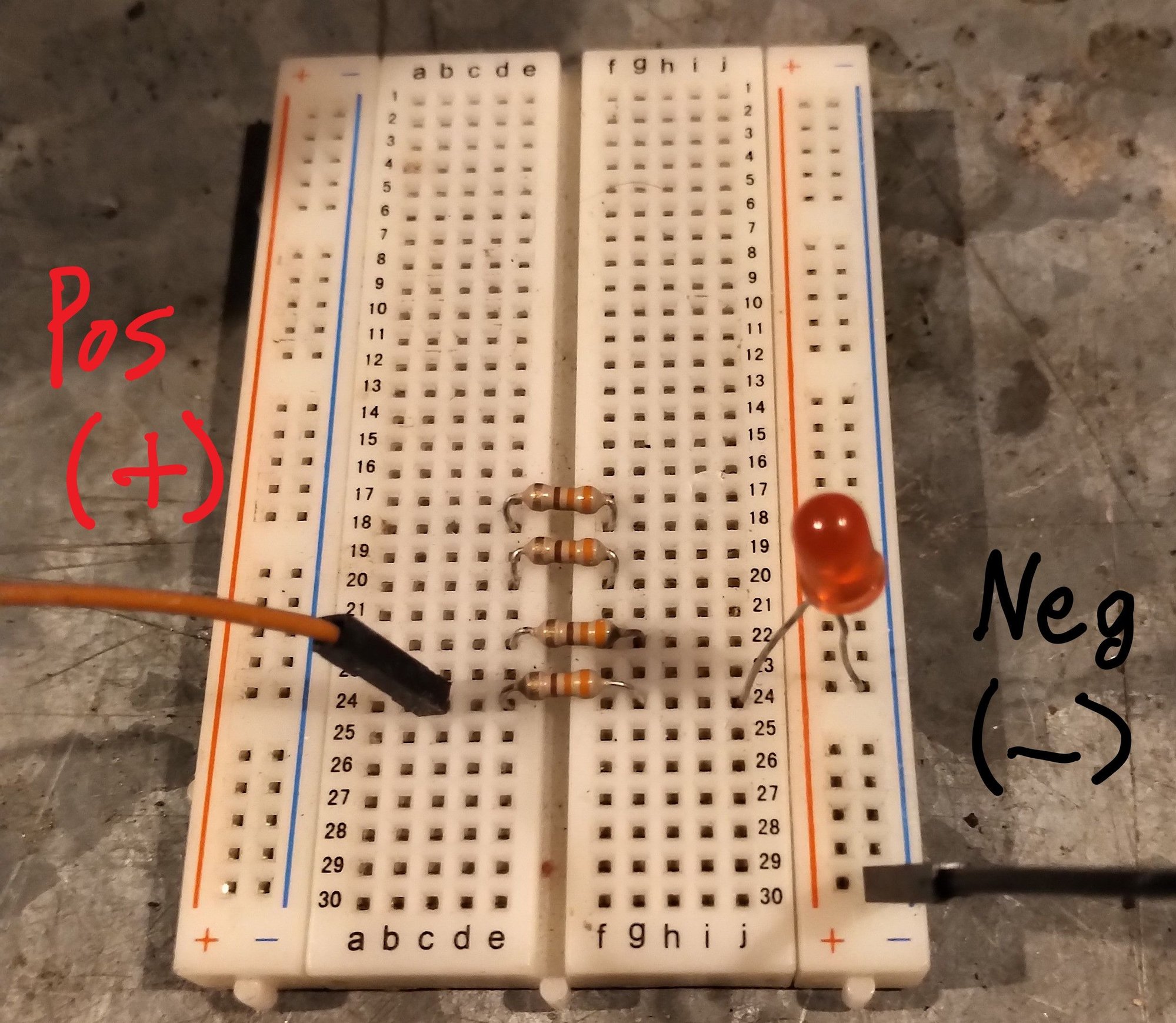

  2. Using an LED: (you need a resistor otherwise the LED will blow)
    1. Create a test lead using wires, 330 ohm resistor (orange, orange, brown), and a RED led (low power, basic led - not the super bright ones) and a breadboard (optional - but easier)
    2. Connect above in this order: Red wire (positive) --> resistor --> LED positive (longer) end --> LED negative --> Black wire (negative). Here’s how I did it:

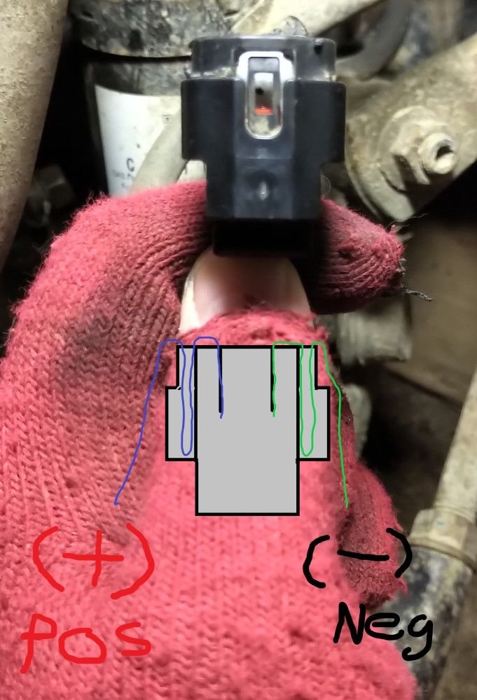

To test this sensor you need to take the LED tester from above and insert it into the ABS circuit. It is easier to do this at the harness connection behind the liner (Pic 6) but it can be done at the connection at the wheel.
  1. Strip the ends of the positive and negative test leads to expose a good inch (4cm) of bare wire.
  2. Insert one wire into one of the connections in the harness. With a small flat head screwdriver, push the wire down into the housing as far as you can go. Then bend the wire around the outside of the housing and hold with your finger or tape. Do the same with the other wire/connection: This shows the basic idea:
  3. If you do not push the wires to make a loop in the housing they will be pulled out of the connections when you plug into the sensor.
  4. Plug into sensor
  5. Turn car on
  6. If the led is on, continue. If is is not, reverse the positive and negative wires in the test circuit. If you still have no lit LED, retry inserting the test led wires.
