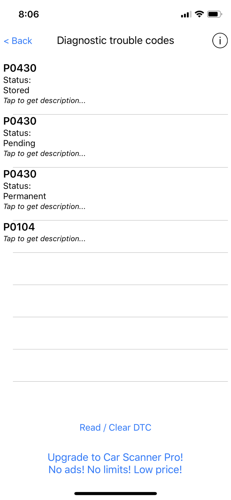

I have two codes
1. P0104 Maf sensor circuit intermittent
2. P0430 CAT bank 2 efficiency below threshold

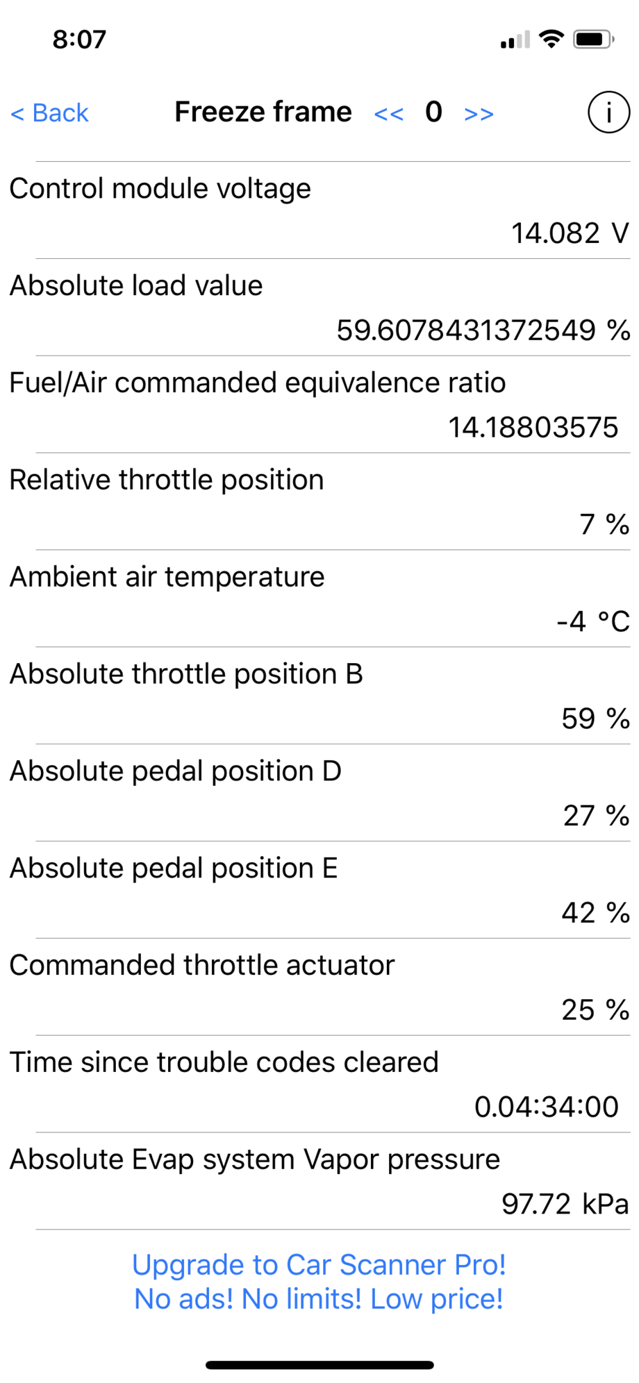

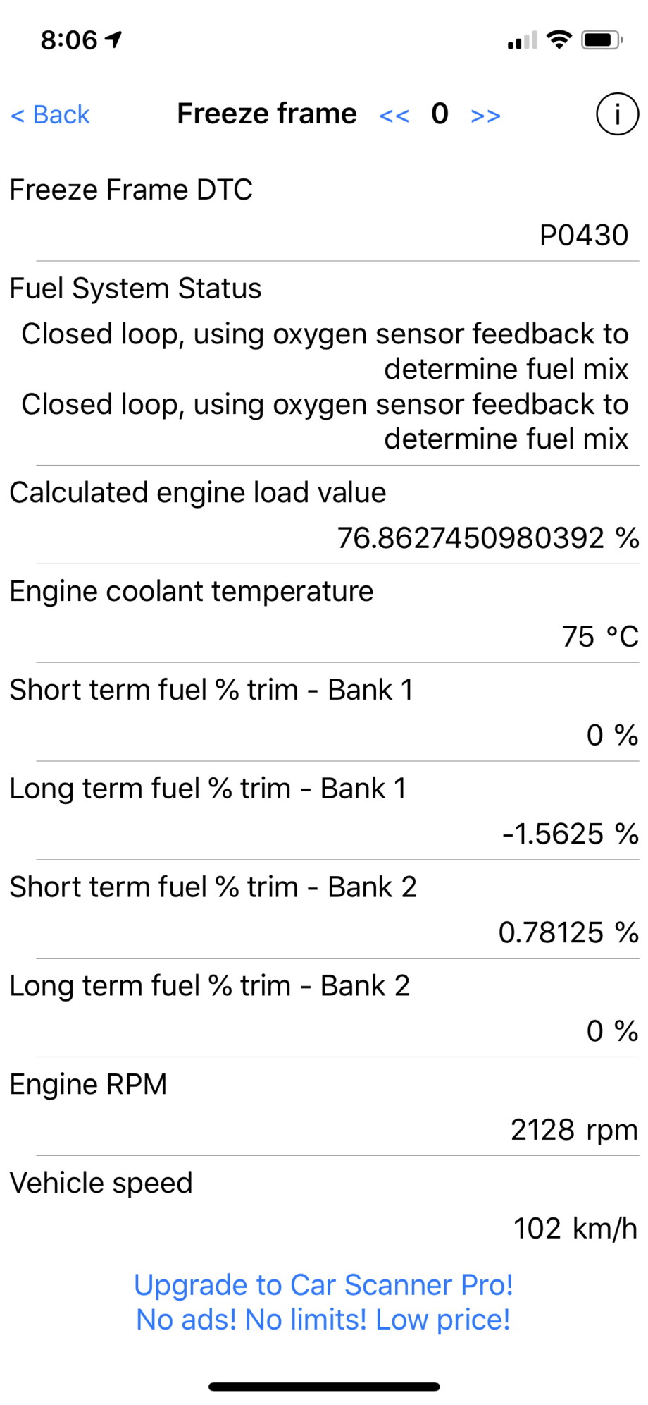

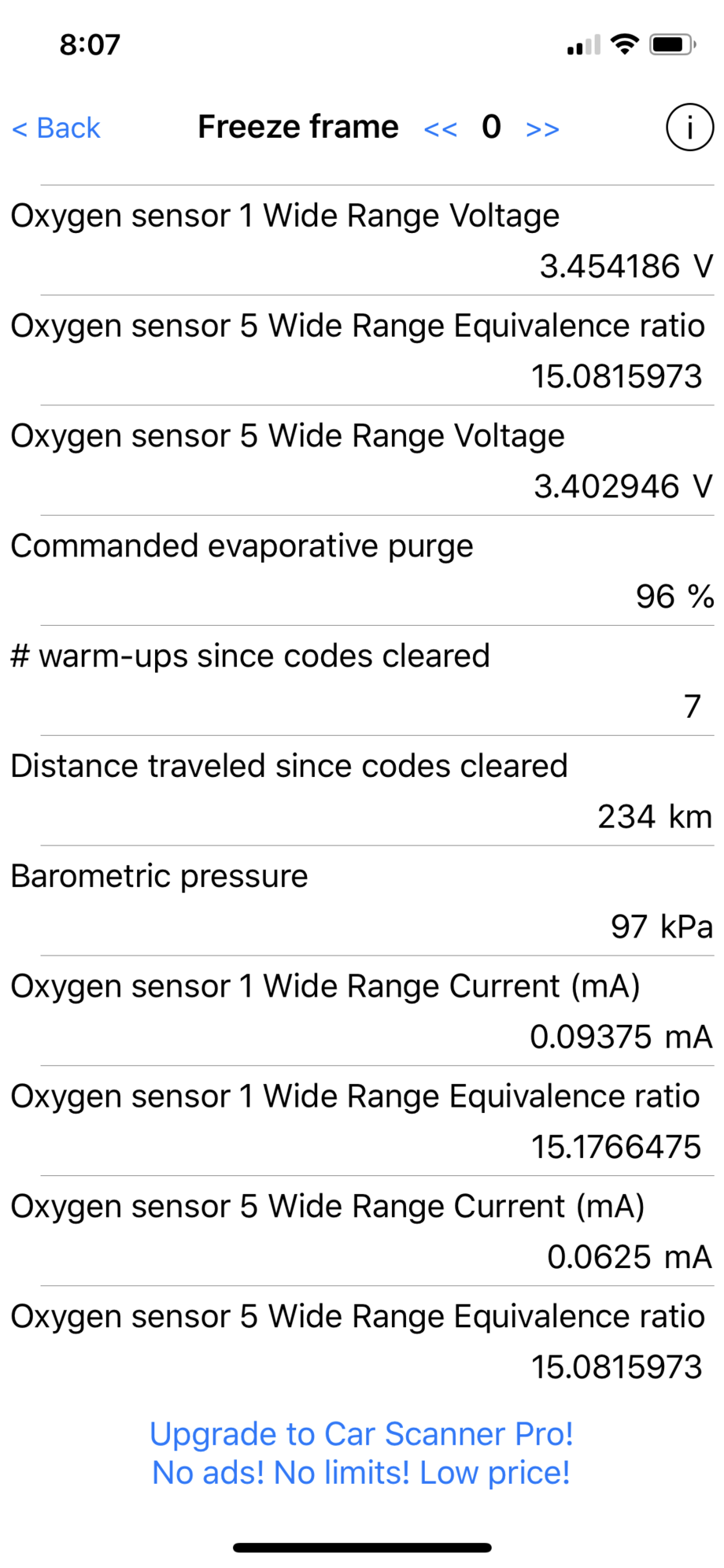

i have attached freeze frame data if some experienced person can help me out here

The P0430 is very likely an exhaust leak in the area of the Y-pipe, perhaps under the heat shield. What happens is that hot exhaust gasses leak out upstream of the secondary cats, which takes them longer to light off -- if they aren't lit off by the time OBD2 diagnostic runs (about 10 minutes after a cold start), you get the P0420 or P0430 code. The dealer will replace the entire section of exhaust at a cost of $2000+, but a good exhaust shop should be able to cut out the corroded section of pipe and fabricate new for a fraction of that.
