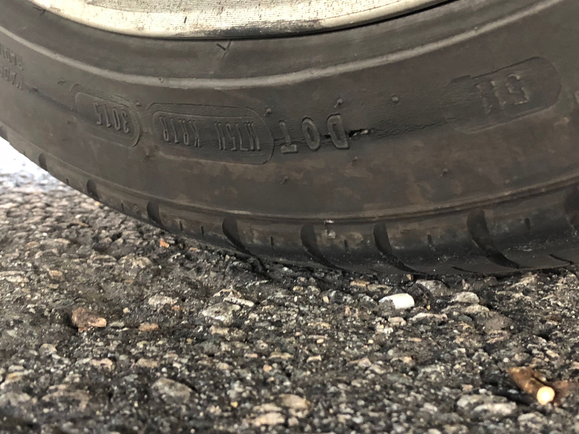

While I was changing the oil I checked the front tires. Found this crack in the left and I checked the true of them and the right tire isn’t true.
Going to the tire shop tomorrow for 2 new tires
TPMS don’t work so I’ll get 4 new ones while I’m there.
Hope this fixes it.

That was caused by a pothole or curb. Did they check to see if your wheel was bent when balancing it all?

Rim has a slight bend to it. I’m probably going to be getting summer rims and tires soon.
