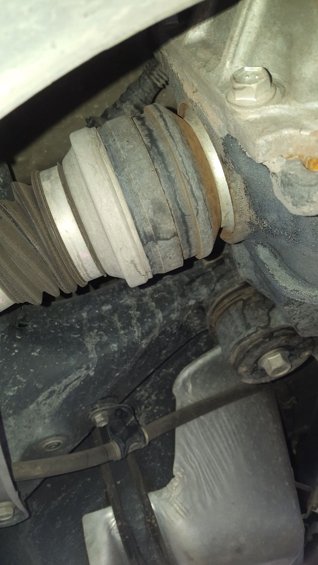

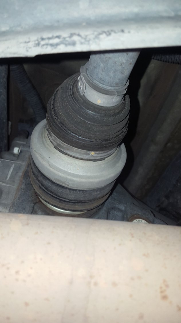

Is your rear axle leaking or is there any signs of a leak from differential? Why do they want to replace your rear axles, is there play are they CV Joints worn out?

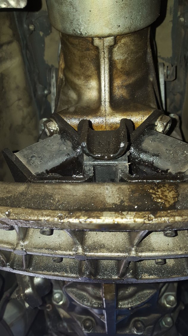

Nov 12, 2017 | 07:55 PM
Alright so while I was changing the oil in my car I took pictures of the rear axles, lca bushings, and my transmission housing. I can definitely see fluid that leaked from my transmission. I've been driving this car for little over 5 months now and I really hope the level isn't low enough to cause major damages. I have ordered two amsoil sae 75W-90 severe quart bottles and i'm planning on replacing the fluid ASAP. I'll take it to a shop to see find exactly where the transmission is leaking from. As for my axles, I'm not too sure, but I see a lot of gunk and what seems to be oil and gunk.
Transmission above the crossmember.
