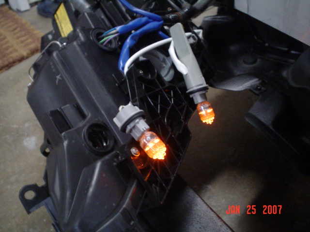

I changed the turn signals to LED. I LoVe it! They do not hyper flash because I used a LED flasher. That part of the DYI is covered by Digiman. Do a search on "LED Flasher".

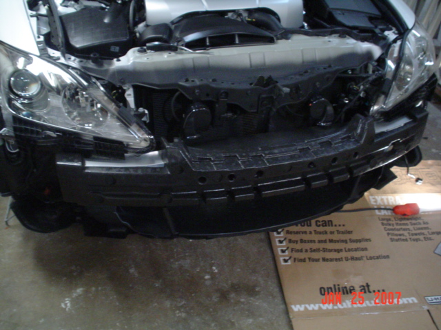

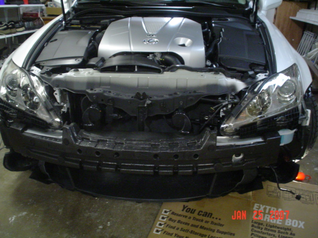

1. Remove all the cllips and screws on the cover.
2. Then remove all the screws and clips on the top of grille.
3. Remove the two clips on each side by the front wheels.
4. Remove all the 10mm screws on the bottom of bumper.
*** If you don't understand the first 4 steps, this is not for you.*****
You will have to pull hard to get the bumper off.

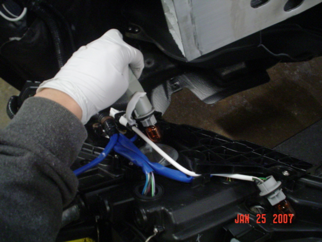

5. Remove 10mm bolts where my finger is in the picture.
6. Pop off the cover expose to clip of headlight.
7. Remove 10mm bolts where my finger is in the picture.

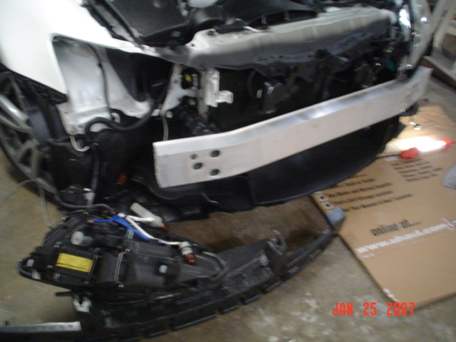

8. Remove support (just pull)

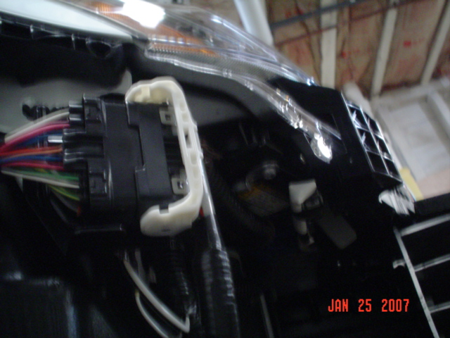

9. After removing the three 10mm bolts, the headlight should be loose for you to pull.
10. I do not recommend to remove the harness. Beacuse it may screw the AFS/HID up.

11. The turn signal bulbs are at the bottom.
Putting it all back together takes A LOT of patients. The fitment is tricky. The whole DIY took 4hrs. I took a lot of time to ensure the gaps are the same as factory.
If I knew it would be this much work, I might not have done it. But now all my lights are all LEDs. I LoVe it!!!!
HAVE FUN!
