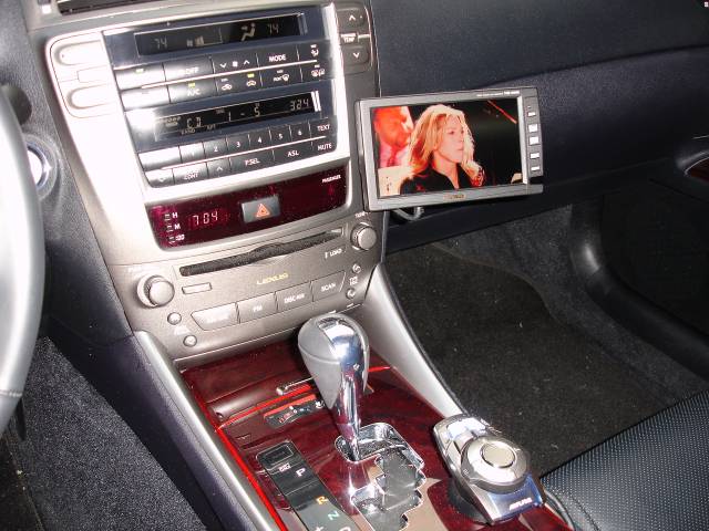

Last summer I installed an Alpine F#1 Status CDA-7990 CD player and PXA-H900 surround sound processor display in my 2IS. I never did get around to making the side trim panels.
I really loved the 7990 but I never did think it looked correct in the 2IS dash. Two months after I did the install Alpine released the VPA-B222 Vehicle Hub Pro that works with a factory audio system. I re-installed the factory head unit and placed the brain unit for the Hub under the passenger seat. I mounted a 5.8" LCD monitor on a cell phone bracket to be the display for the Hub. I mounted the Hub controller on the center console with double sided tape. I can control the whole audio system through the Hub.
Later this year Alpine is releasing a new touchcreen monitor that will take the place of the Hub controller on the center console and will replace the current LCD monitor.
Cmusic, ive checked the Alpine website and ive been wondering what the VPA -B222 does. Does it intergrate with the factory audio or do you control every thing via the hub? Can it be intergrated with the factory amps just to add video? Also, the the 5.8" monitor interfere with the opening of the glovebox?
thanks..
Old Jan 19, 2007 | 07:32 AM
  #68
cmusic's Avatar
cmusic
Joined: Dec 2005
Posts: 243
From: Kentucky
The B222 Hub is a master audio/video Alpine Ai-net system controller. It has many inputs for sound and video. It can control any piece of Alpine equipment that is equipped with Ai-net. It controls my Ipod directly through a special cable (the Hub controller overrides the Ipod wheel control and the Ipod’s display is show on the LCD monitor). It can control Sirus, XM, and/or HD radio with extra modules. It controls Alpine 5.1 surround sound processors, Alpine CD changers and DVD players, and anything else that is Alpine Ai-net controlled. It can control any Alpine navigation system. Everything is controlled through the Hub controller and shown on the LCD monitor, except for the factory system. It has RCA outputs to use with other aftermarket amplifiers. It has two A/V inputs that can be used with a Playstation, X-box, a different brand of DVD player, camcorder, or anything else with A/V outputs.
With an additional module you can have additional LCD monitors for the rear seat showing different video and audio. For example you could be showing the Alpine navigation on the front monitor with the factory system audio playing over the main sound system and have a DVD playing for the rear monitors with the DVD sound going to wireless headphones.
It has a two-channel speaker level input for use with factory systems. Since the 2IS factory amp is multi channel, I had to use two 4channel LOCs (line output converters or speaker level to RCA converters) and RCA “Y” cables to blend the front mid/tweeter, front woofer, and sub speaker level outputs into one two-channel stereo signal to go into the Hub. I hit the source button on the Hub controller, choose “FACTORY SYS”, and operate the factory audio system as normal. The Hub’s volume control is the master system volume control, but I usually turn it all the way up and use the factory volume control.
With some creative wiring the Hub might be able to be wired into a non-ML 2IS audio system to use the factory amplifier and speakers to add DVD video and sound. Actually you would not need the Hub to do this if you just wanted DVD sound and video. All that would be needed is an aftermarket DVD player, an LCD monitor, and two relay switches. The audio would be in stereo, not surround sound. It would be nearly impossible with the ML system to do this.
The Hub does have a built in 50x4 max power amplifier (18x4 RMS) to power aftermarket speakers if desired.
The 5.8” monitor does not interfere with the glovebox. The cellphone mounting bracket the monitor is attached to was designed to clear the glovebox door when opened.
thanks..
Your welcome.

Cmusic,
Which set-up sounds better? I have the same stock set-up as you. Is the difference worth the work?
Do you have more "hiss" than stock?
Old Jan 22, 2007 | 05:49 AM
  #75
cmusic's Avatar
cmusic
Joined: Dec 2005
Posts: 243
From: Kentucky
Originally Posted by Dj_AmtraX
Cmusic,
After the Hub I have Alpine 5.1 surround sound processor, Alpine amps, Alpine 10” sub, and Boston Acoustic speakers in the front doors. I also have an Ipod and Alpine DVD changer in the system. The stock system is no slouch but the aftermarket system I have put together sounds much better. It has no hiss at all when playing the DVD or Ipod. The factory deck has a slight amount of hiss in it that can't really be gotten out.
