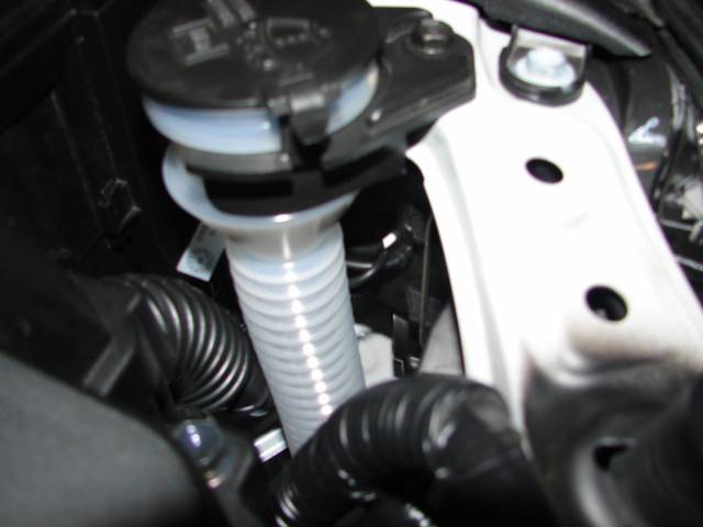

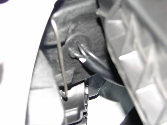

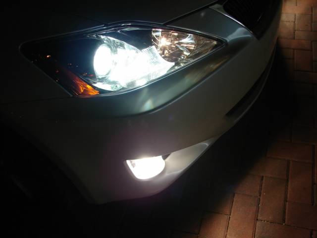

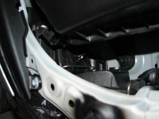

Hey guys and gals, here is a few lazy pictures of my HID install, I'll post more pictures when I take them, but as you can see the Xenon Depot kit comes with very nice grommets, I've gone through some heavy rain, those of you in Miami, now what I'm talking about, and no condensation.
These grommets allow for all the wires to be passed through them, and you only need to drill about a 12 mm hole.
All the wires go through one grommet, only one hole, no huge drilling of the dust cap.
The result, very pleased, very high output of light

which color temp is that?

they are 4300 the higher you go on the kelvin scale the less usable light you have, but it's looks cooler
