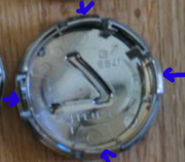

In order for the Lexus cap to fit on the Zenetti Wheels, you need to modify it a liltle bit. All you need to do is get a small saw and cut 4 plastic pieces that I show you on the picture. You need to remove the wheels to install those.
how do they stay in? just wedge them in and they stay in tacT?

Lol, I'm glad that you like all my mod. . Yes, just push it in and they will stay intact. It take a a liltle force to get it in but that's good, that'll make the cap stay on the rims.

how far down did you cut those 4 clips? and the 2 spots i marked with the arrows, those will fit into the small groove around the zenetti cap? or did you take the zenetti cap out before putting the lexus cap on?
how come you had to take the wheel off?
thanks

You have to cut those 4 clips to the base. You have to take the wheels off because it's no way to take the zenetti center cap off the wheels. You have to push them out from the inside. I scratch 2 of them trying the short way not to take the wheels off.

ok now i understand..i wasnt sure if you took the zenetti caps off or just covered them..thanks for the help
