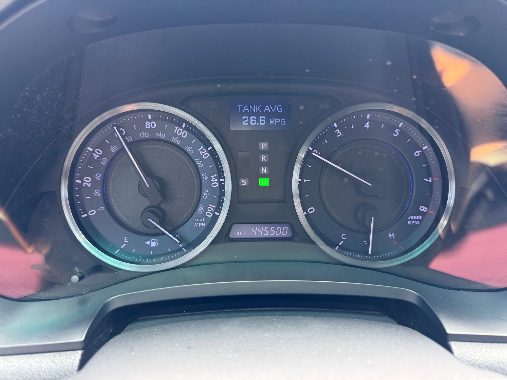

Just wanted to chime in. Car just hit 445k today! My daily driver. Been my main squeeze, my ride or die since 2011.
