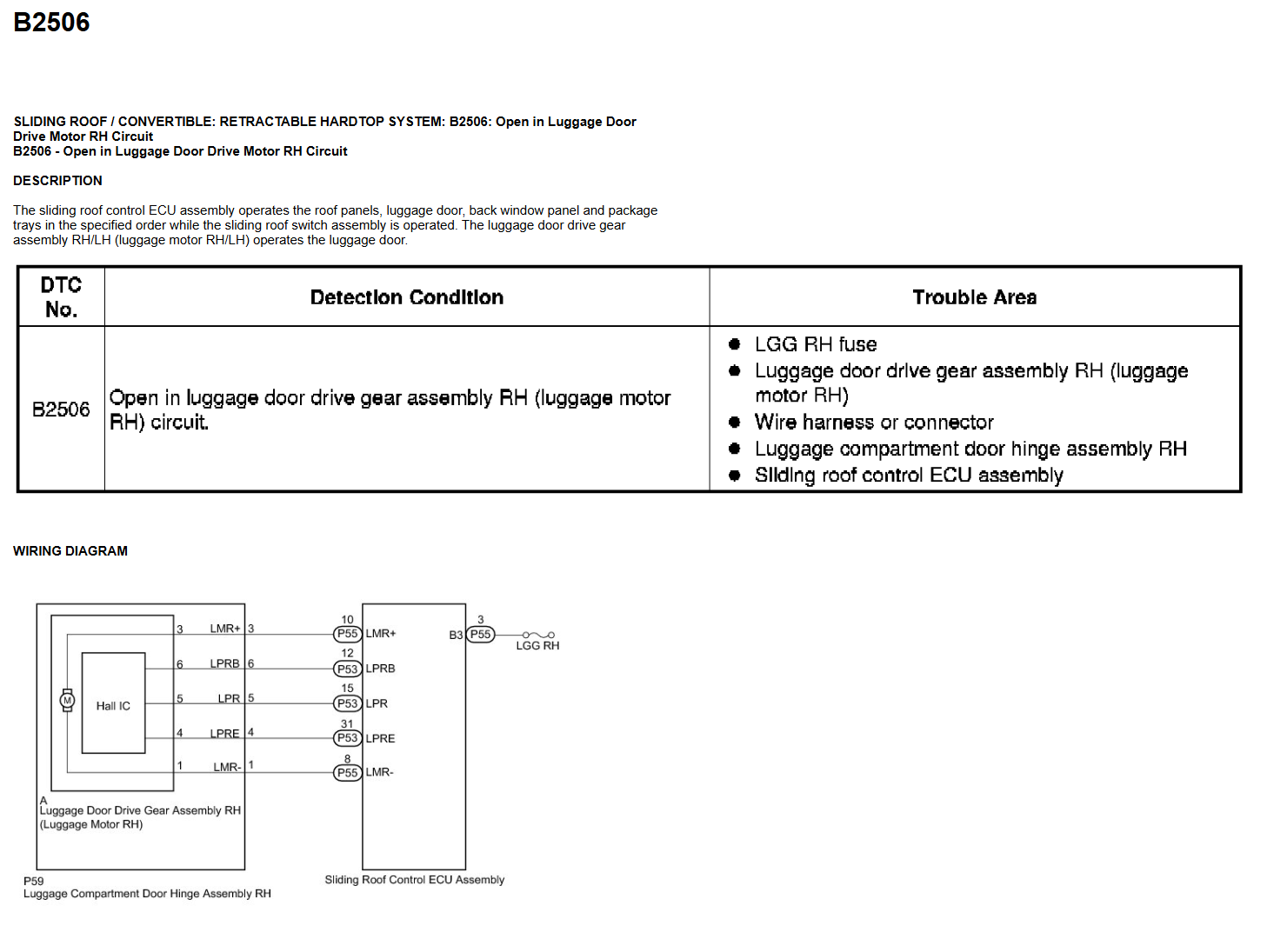

Anyone ever work on their convertible top? I am getting a Code of B2506 "Open in Luggage Door Drive Motor RH Circuit" which I perceive to mean the motor that opens the trunk is bad.
Do anyone know if it is the motor that is closest to the tail light? or the one closest to the cabin?
Anyone perceive that error code to mean anything different?
Anyone have a factory repair manual that could shed a little more light on my problem?
2010 IS250C

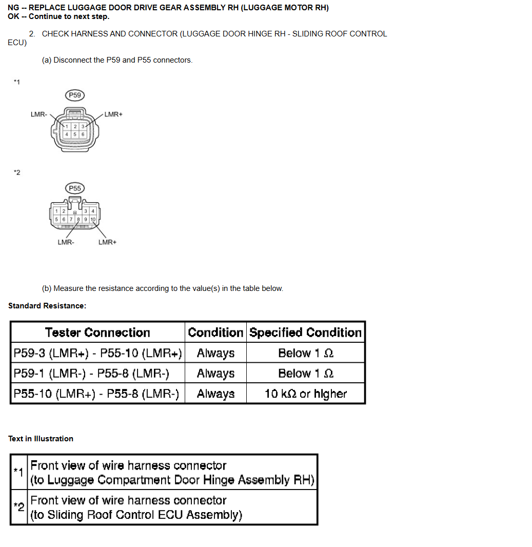

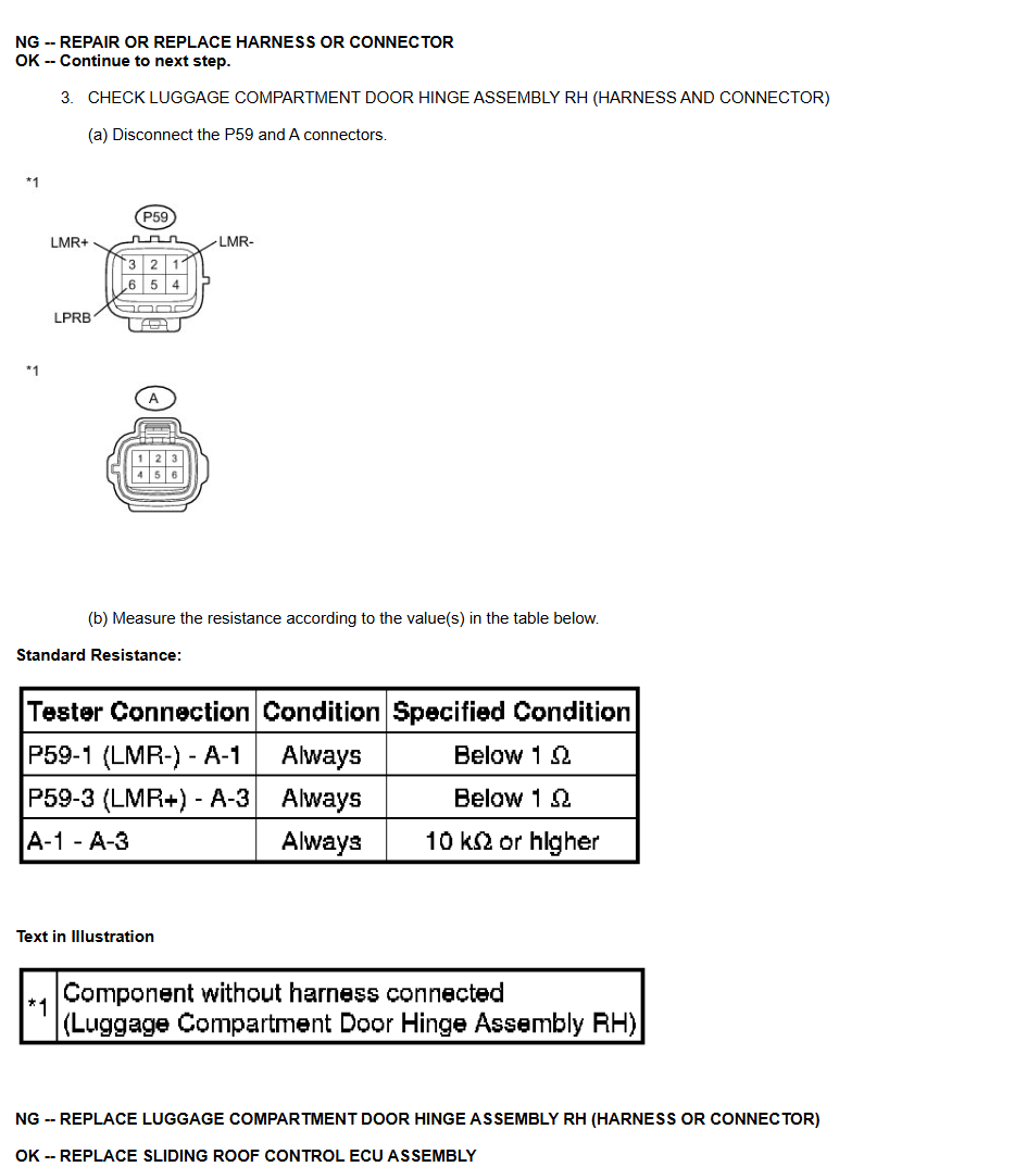

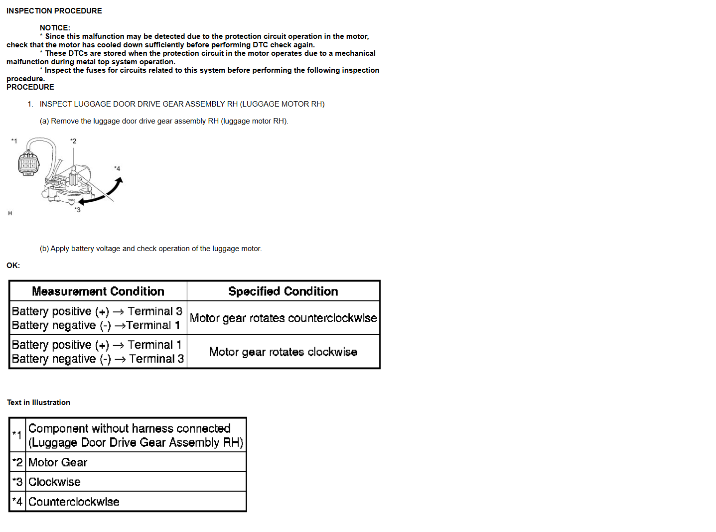

That is awesome! THANK YOU @Inactive ! Now I can ohm out the motor and see if is shot, or if it is something else
Google's AI Gemini insists it is most likely a broken wire from the hinge opening and closing so much. It sounds like a possible diagnosis, but finding the wire bundle is pretty tough.
Has anyone else ever heard of a broken wire in the hinge assembly?
