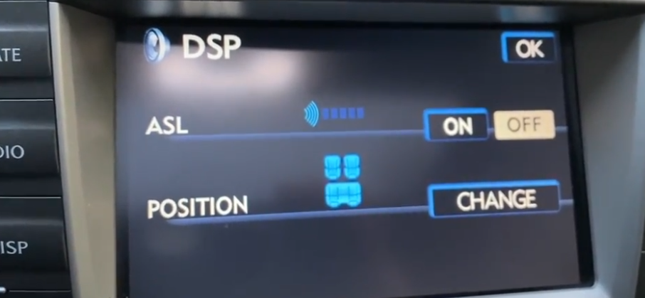

Again, your issue is one side of the vehicle has no audio when the AUDIO settings / position are moved (L / R / Front / Rear)? Does the audio change if you toggle the ASL ON and OFF? Have you already checked related fuses?
