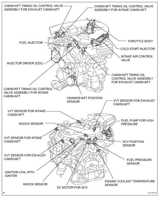

Hi All,
Wondering if anyone can help, I have a right hand drive Is350 and was wondering the location of the driver injector, 898871-30030.
I have the error code U0105 which I am sure is due to the fuel pressure sensor.
Thanks

The part you listed is on the front of the engine. See diagram. The suspect item is on the rear of the engine. See Fuel Pressure Sensor.
Is this error constat? Does it run?

Thanks for the diagram.
The engine turns on then shuts off straight away, reading the previous posts about the error code U0105, the culprit more than likely is the fuel Pressure senor needing to be replaced.
