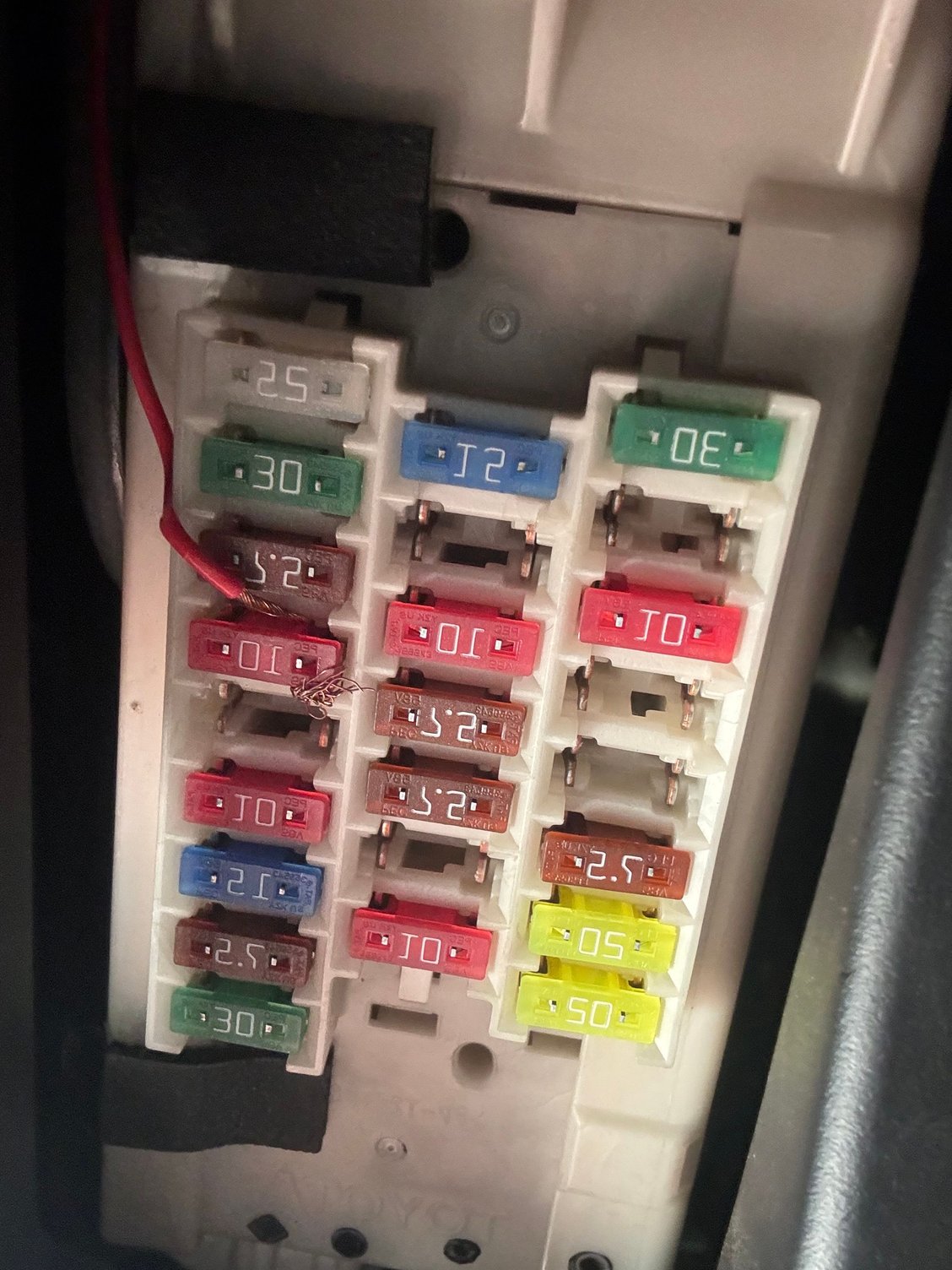

I replaced the headlights with diy
But I can't get the passenger seat, the rear window down from the driver's seat. It's not working
The lights all work well. 7.5 has been removed from the driver's fuse box to remove the warning light
Please solve the window problem. I beg you
