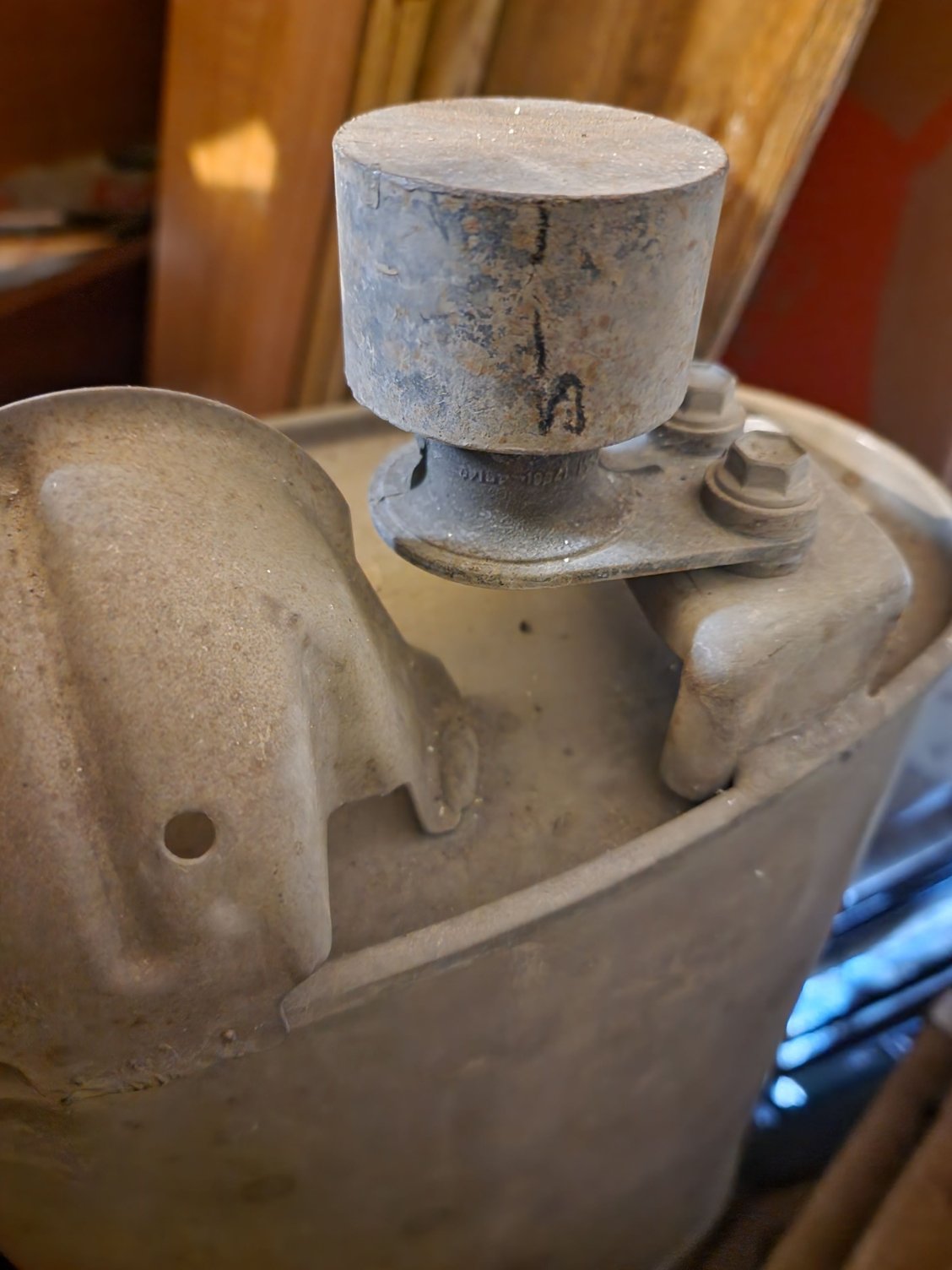

17581A is just the exhaust damper. It's supposed to be like that. Respectively #2,3, and 4 should have the rubber hangers. Look at the picture I posted top right detailed view.

Yeah its just a damper.
Here's my stock exhaust sitting in the garage about 6 years now.
