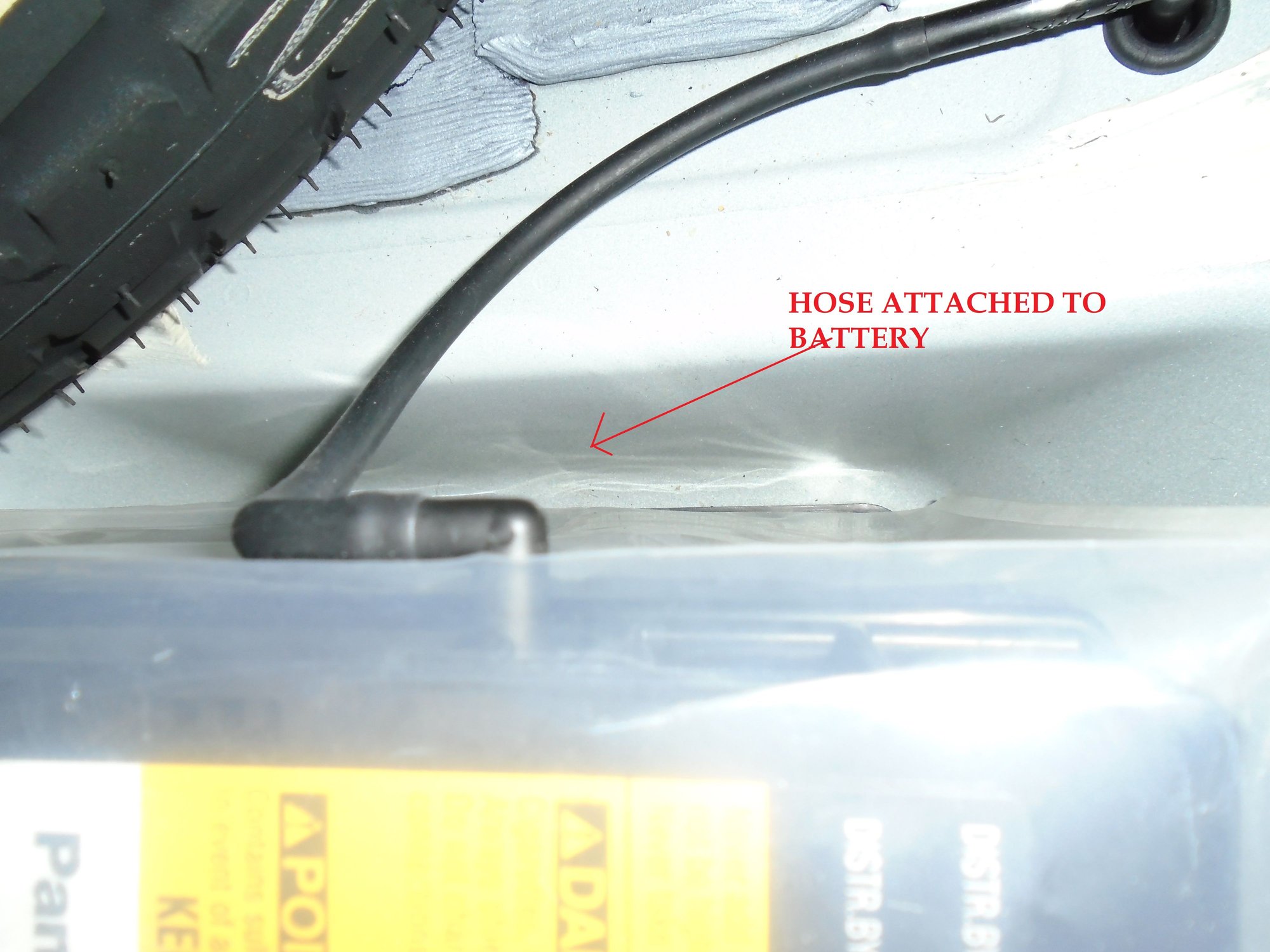

I noticed that the battery has some sort of a small hose attached to it. If I were to replace the battery, I guess I need to get one with the hose outlet and unplug the hose from the old battery. I would appreciate any suggestion for a good battery.

Battery is kaput.
Hose is hydrogen gas vent.
No one makes suitable batteries with those vents, far I know.
Here's more than extensive 12V discussion. Same battery is in your car
https://www.toyotanation.com/threads...ative.1656016/
