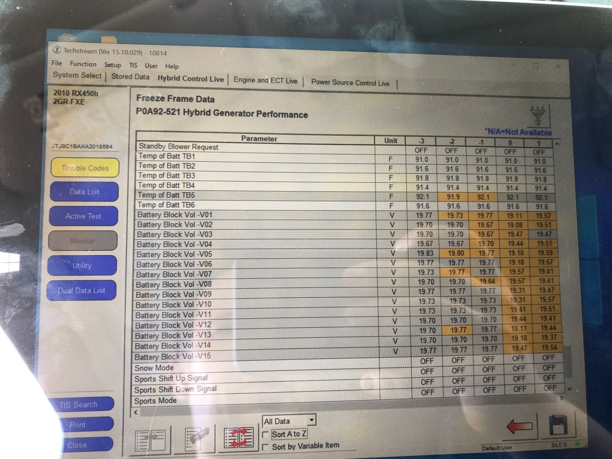

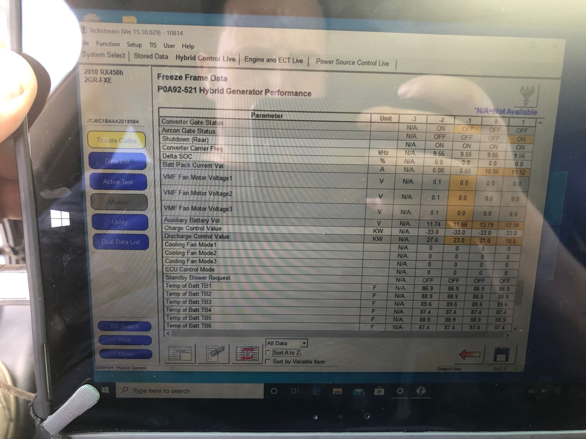

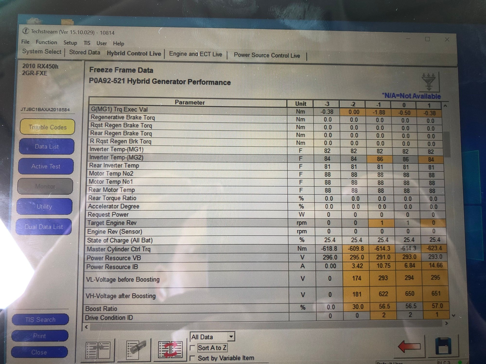

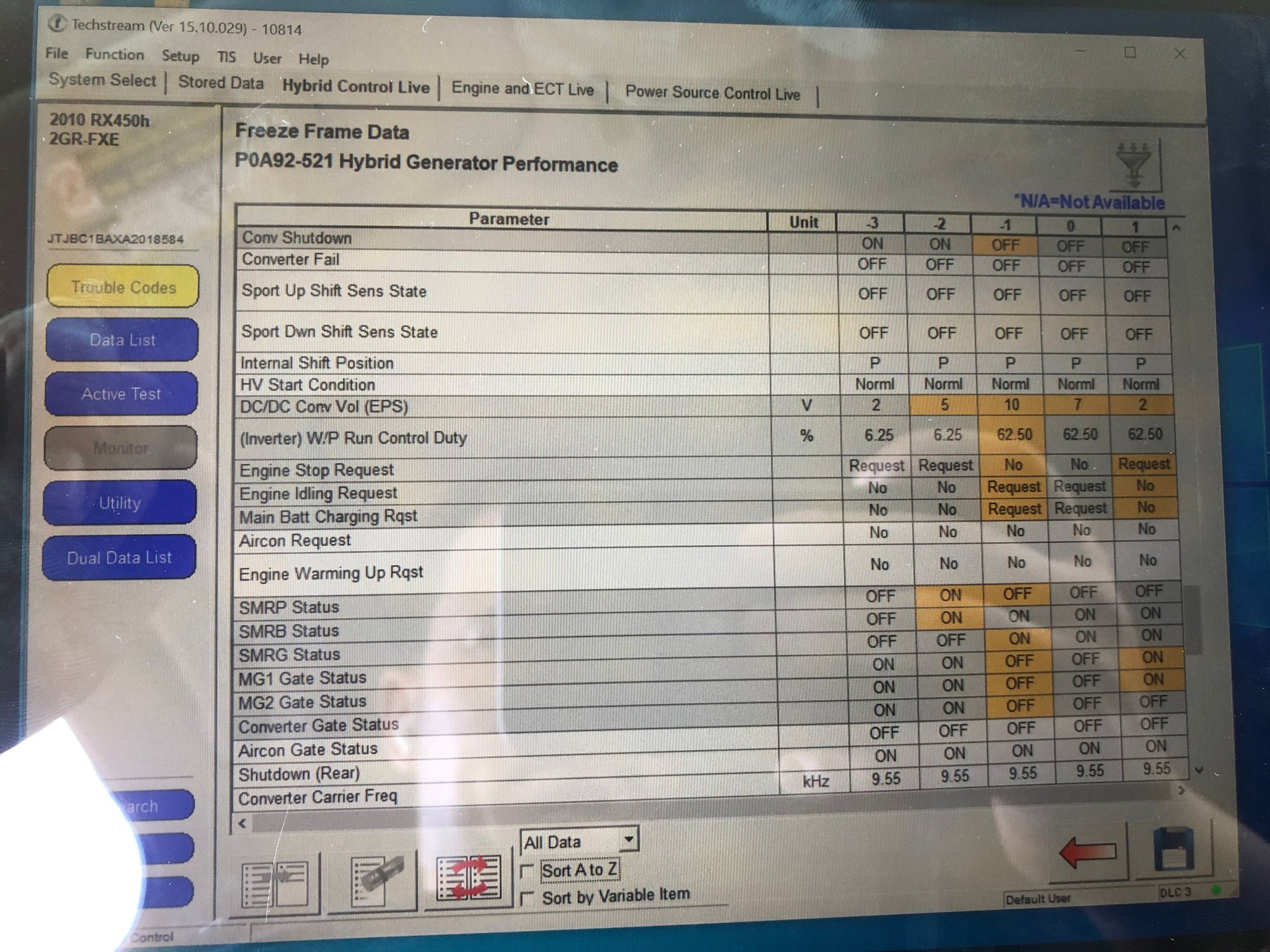

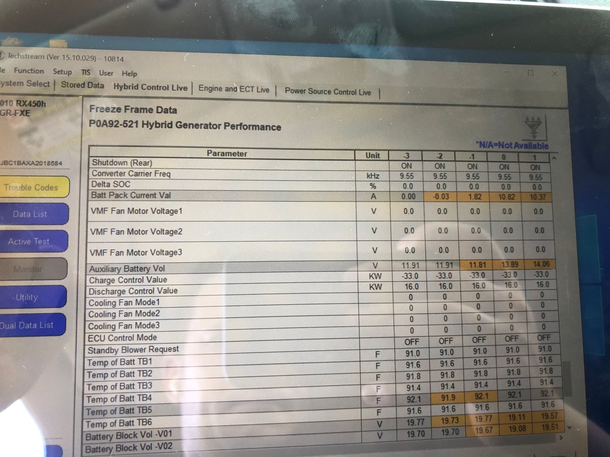

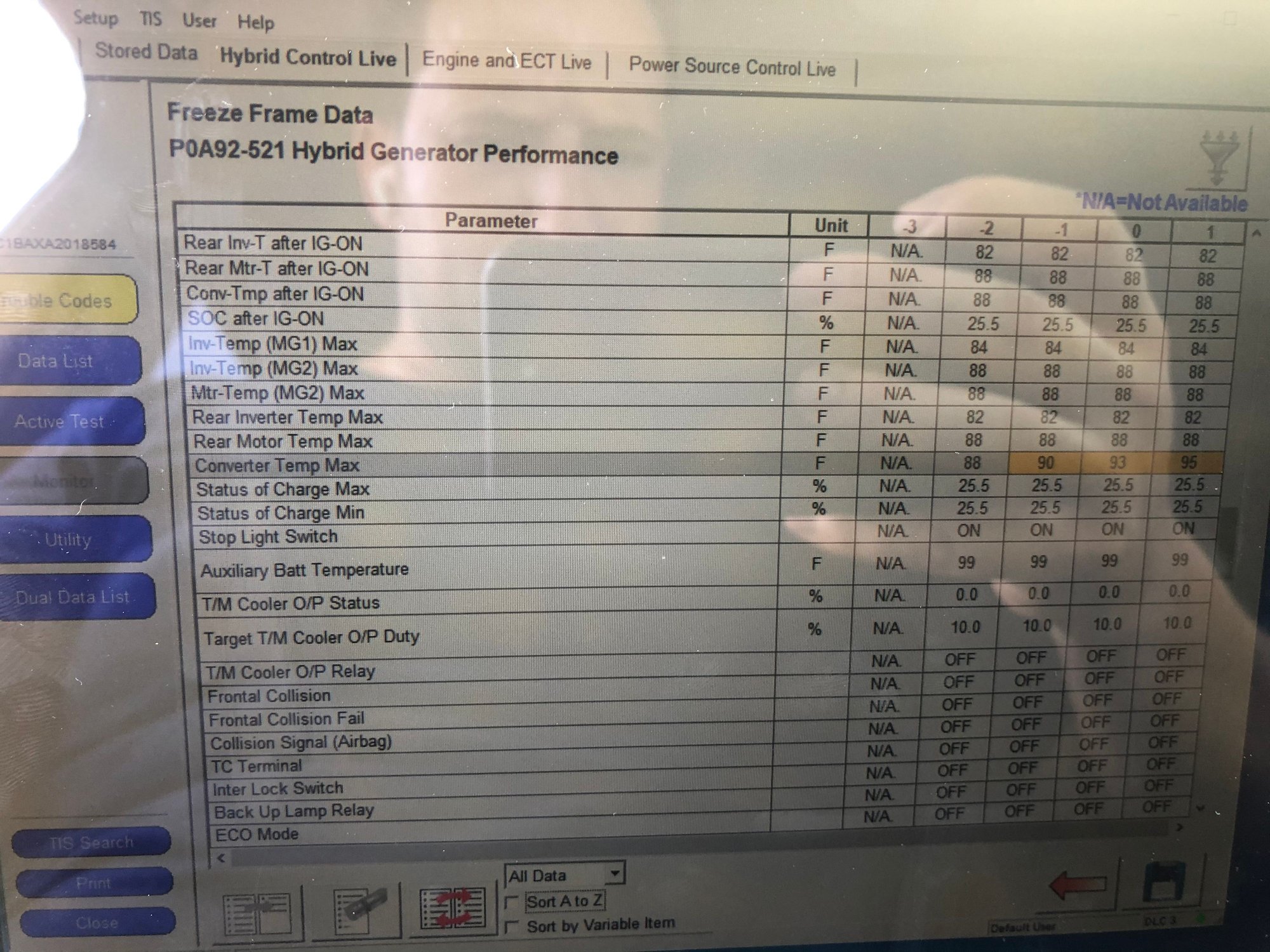

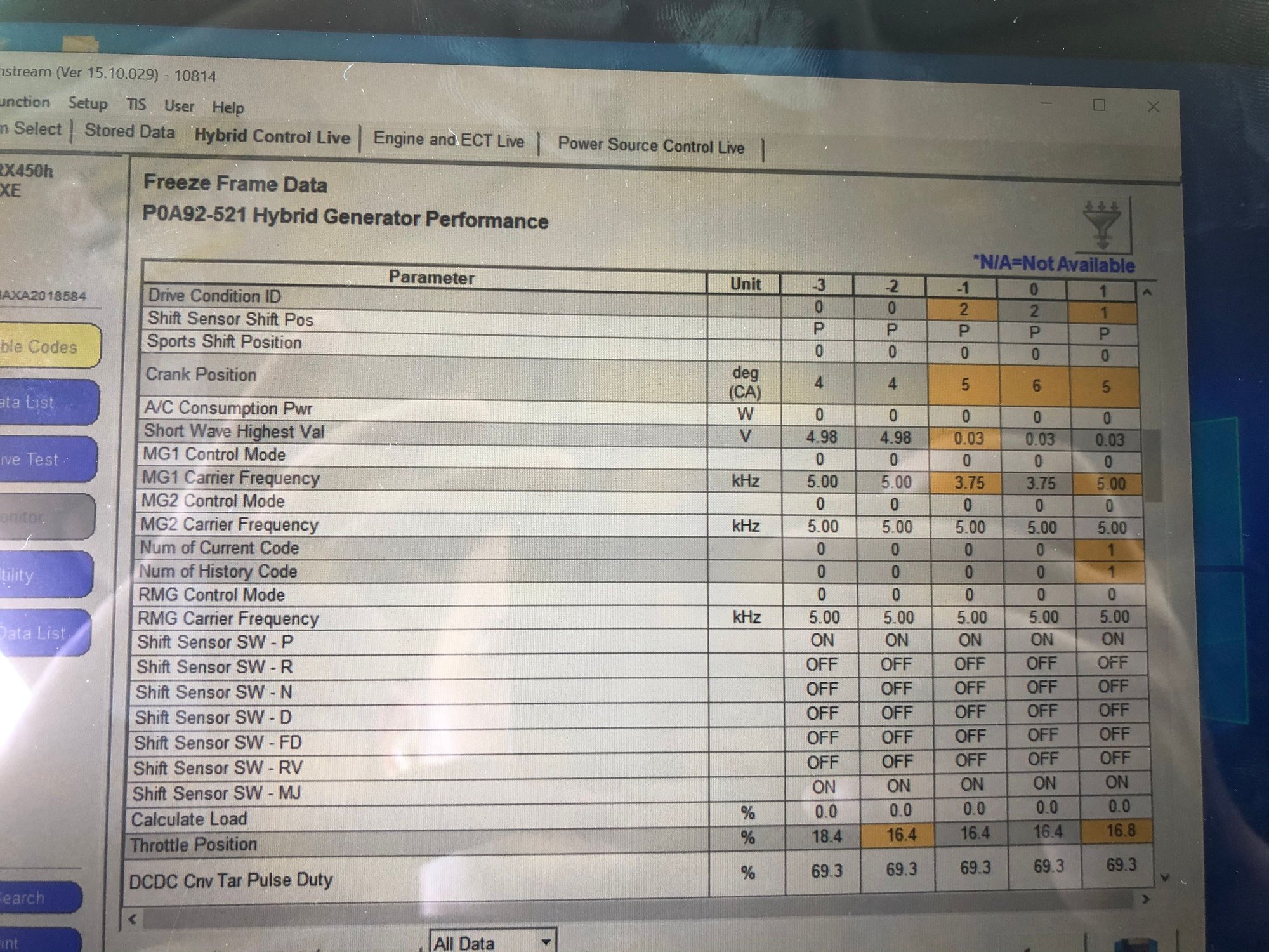

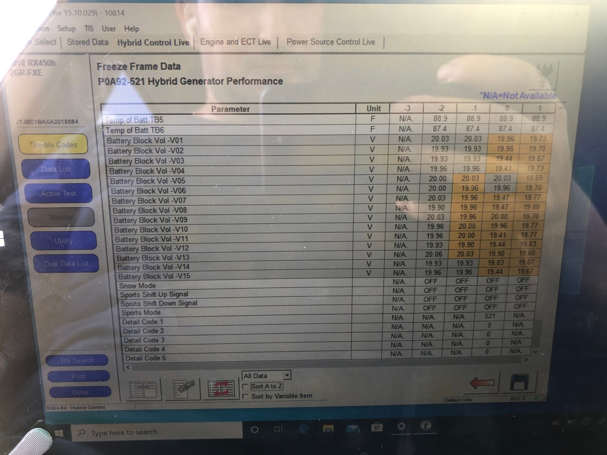

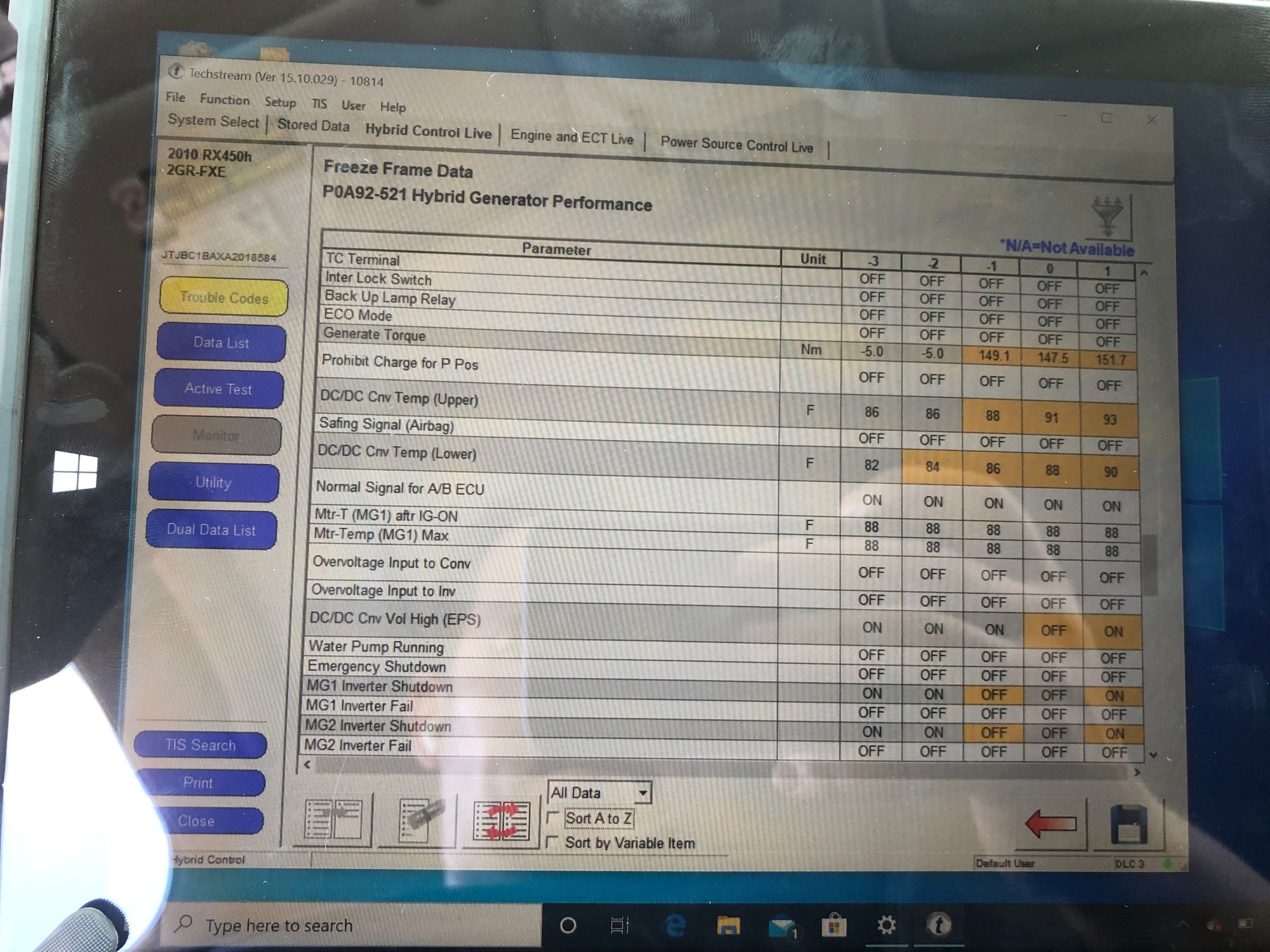

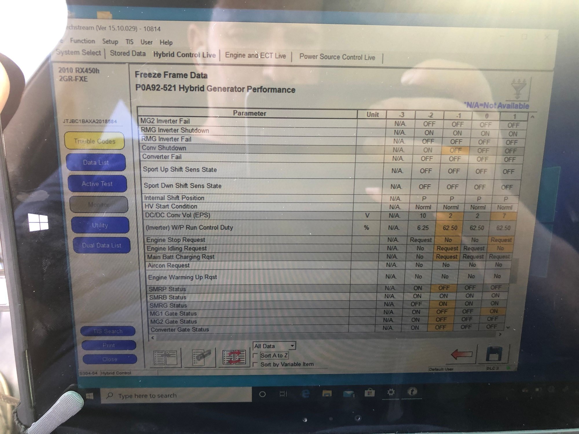

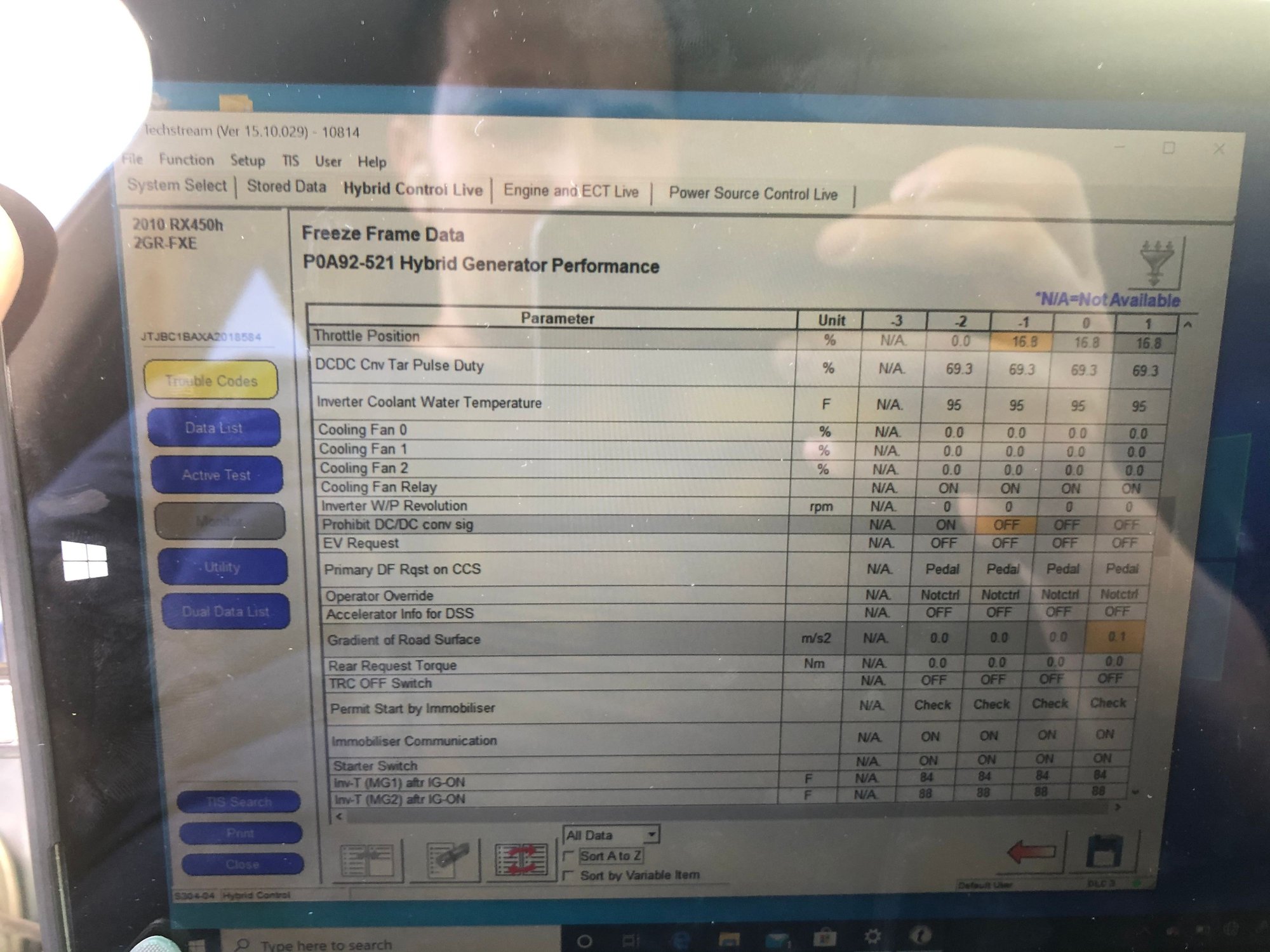

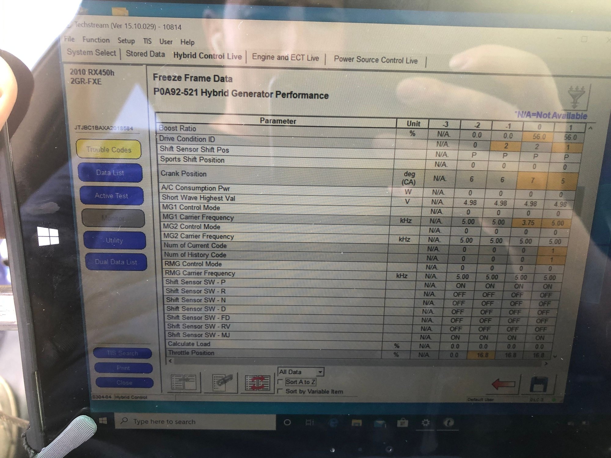

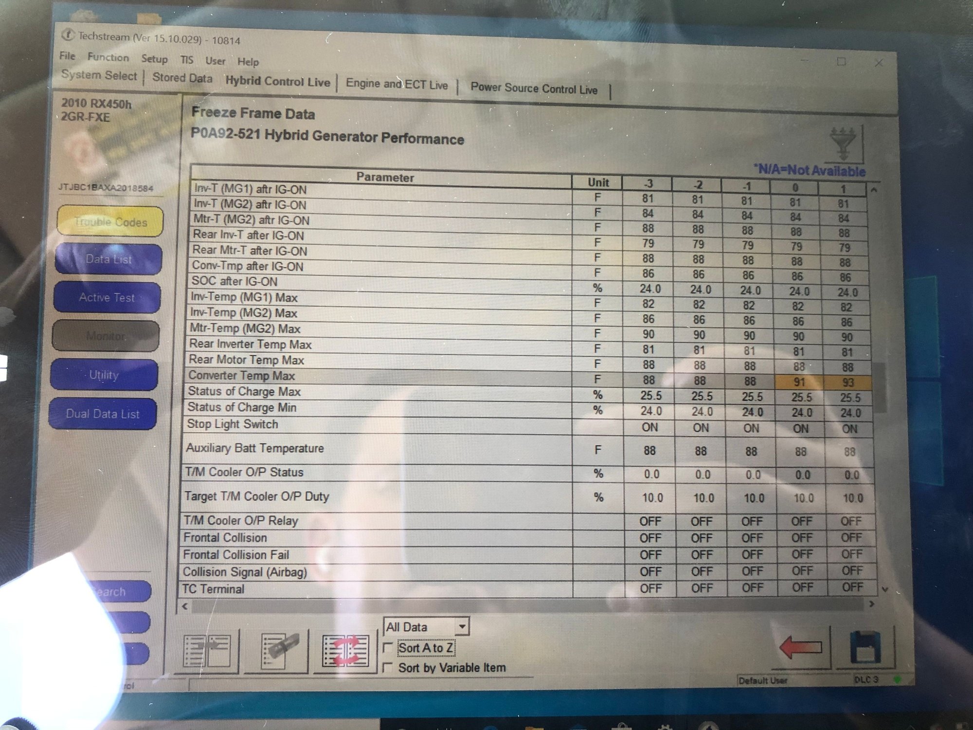

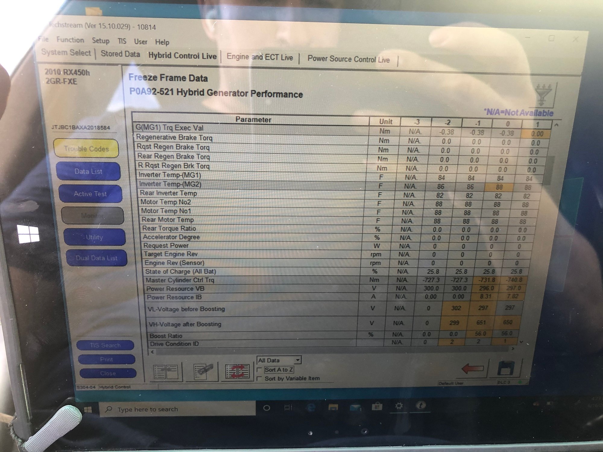

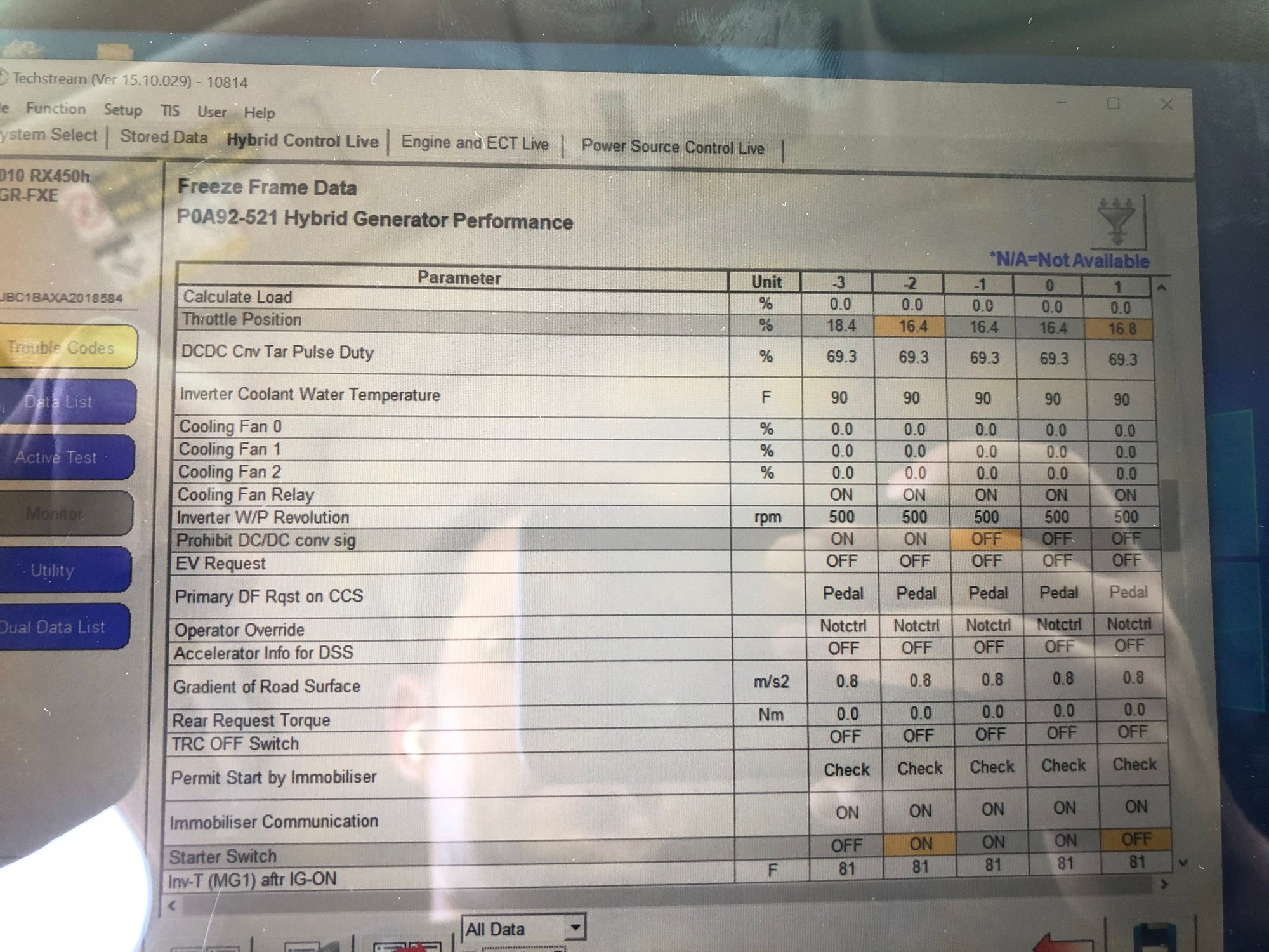

I got that code and was able to drive 2000 mil back home. I was thinking it is a transmission problem but after replacing transmission I have the same code. Cant start

Update: It was an Inverter problem. After inverter replacement, everything works perfectly.
inverter price (eBay) = $880+coolant
labor = 2H
