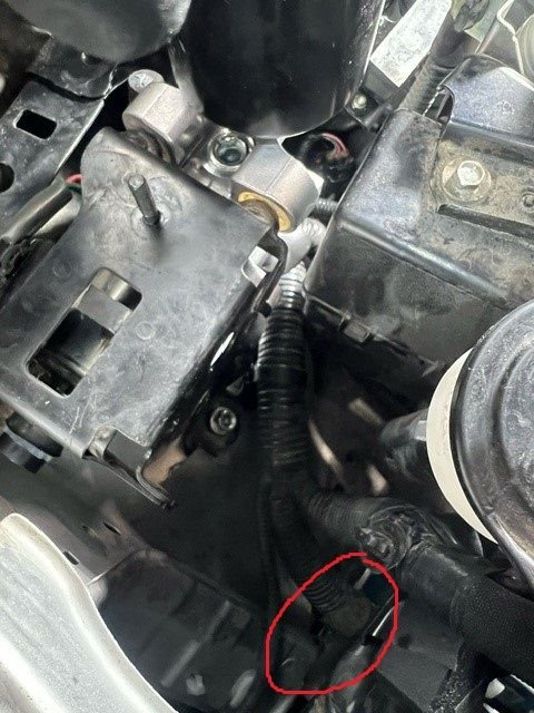

Fairly simple DIY. The only reason this took so long was because this was the first time working on any ABS related repair so went extra slowly/carefully....also, the screw/bolts holding the lines to the actuator take forever to unscrew....and then there are two harness connectors deep inside the engine bay…one near the front of the pump assembly and the other to driver side of the actuator (white clip)…see pictures…by using a straight edge screw driver I was able to pry these loose…once they are free the brackets holding the actuator and pump can be removed…lastly, when you pull the pump assembly out of the vehicle, there is a round clip that is holding the pump to the bracket....this clip you can use a pick tool to bend the fasteners back slightly...just pull and the clip holder will unfasten and you will be able to replace the pump into its bracket....after replacing both parts I bled out all four corners and used a scanner to run the linear valve offset procedure. No more ABS, Brake, and traction control lights on my dash!
here are the part numbers: Actuator 44050-48320, Pump 47070-48060
