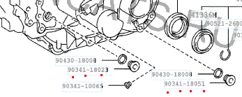

Good day sirs.. this thread has been most helpful so thanks to all involved for great pics and links. My 2006 RX400H is nearing 191k and i wanted to drain and refill the atf ws however my bolts are rusty and old looking..
was wondering has anyone replaced the 10mm bolts altogether? what are the part numbers? Is there a different part number for the drain and fill bolts? I have already bought the washers suggested but i can't seem to find bolts on rock auto..
Much appreciated.
Old Aug 17, 2021 | 08:39 PM
  #60
iMSQ's Avatar
iMSQ
Joined: Aug 2018
Posts: 999
Likes: 228
From: NM
Much appreciated.
For transmission - Yes (the same)
For rear diff - NO
