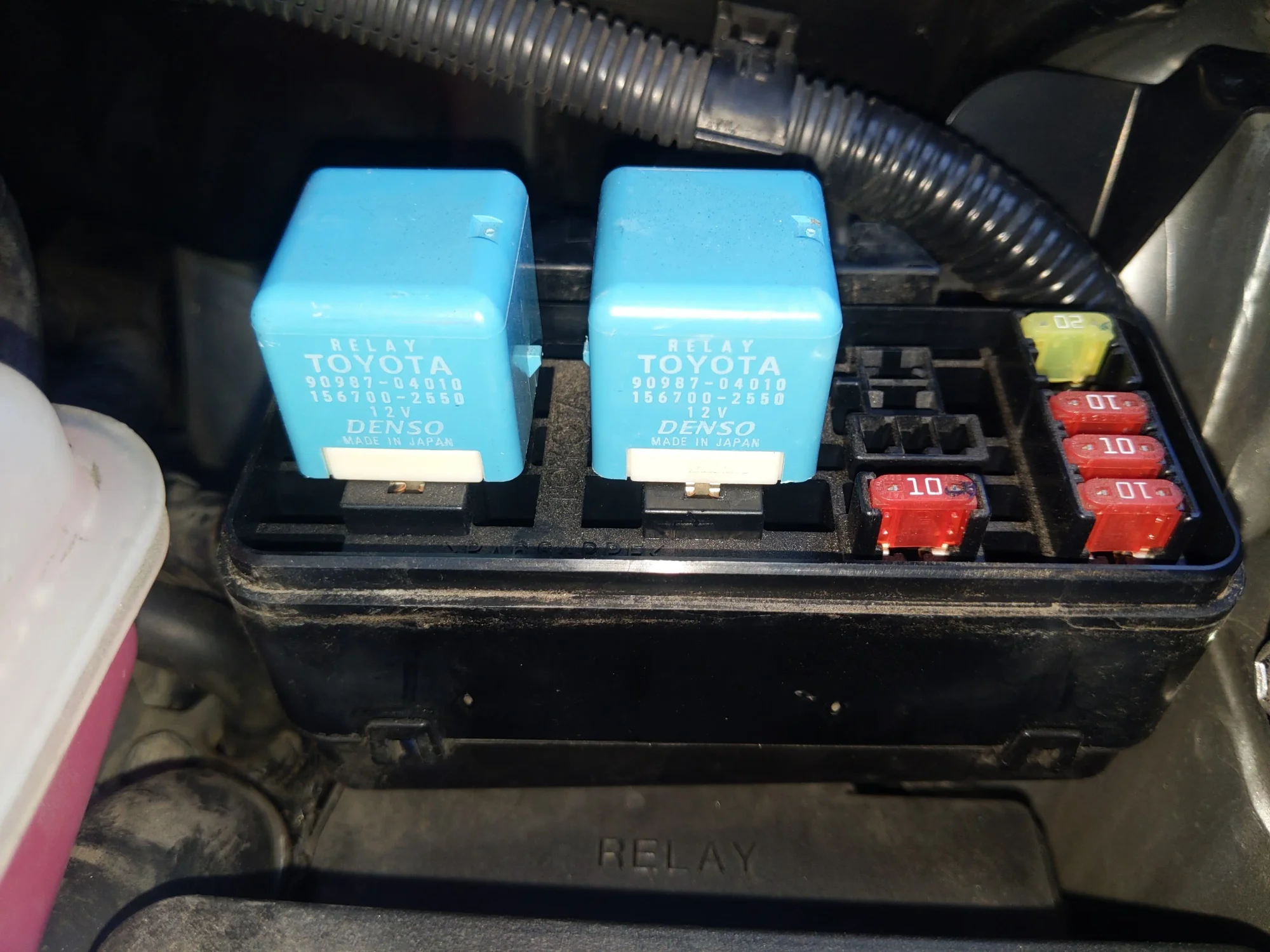

I know many people don't like these, but I'd like to get them working. The high beams work but no DRLs. Here's what I already did:
1. Check Techstream (not disabled)
2. Check fuse is good.
3. Relay appears to be the correct part#. The relay is also the same as his neighbor, the heater relay so I was thinking of swapping them. Is there a trick to removing the relays? I pulled a little and they didn't give.
DRL and Heater Relays

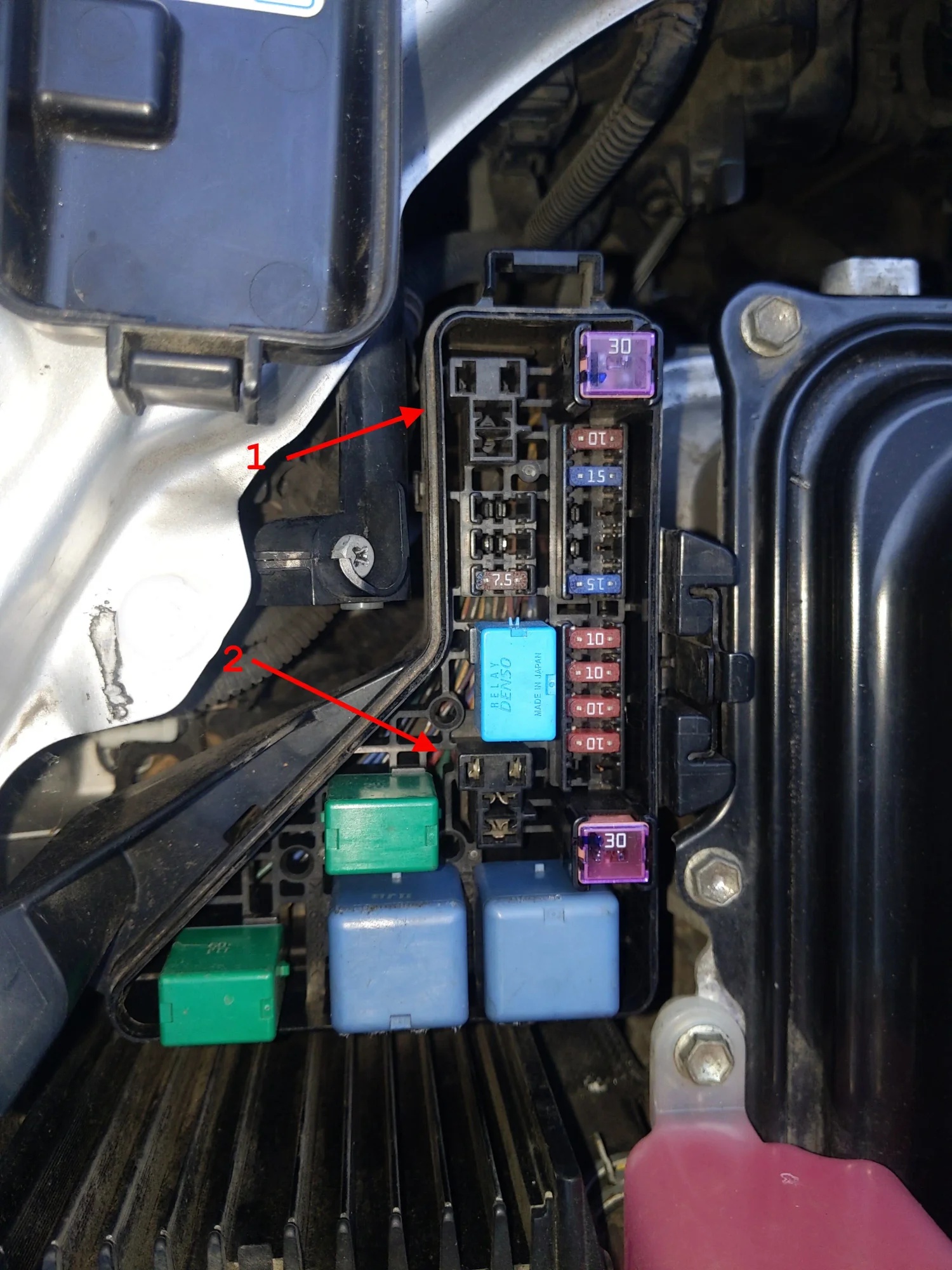

4. Probably not related, but.. Is there something missing here (#1 or #2)
Something missing here

1 has no pins in the relay block, 2 does. What does the cover show? Those relays are stubborn I've broken them grabbing them at a salvage yard.

Thanks, I'll check what the cover says on that potentially missing one.
On the relays, should I try some pliars or spludger on the bottom?

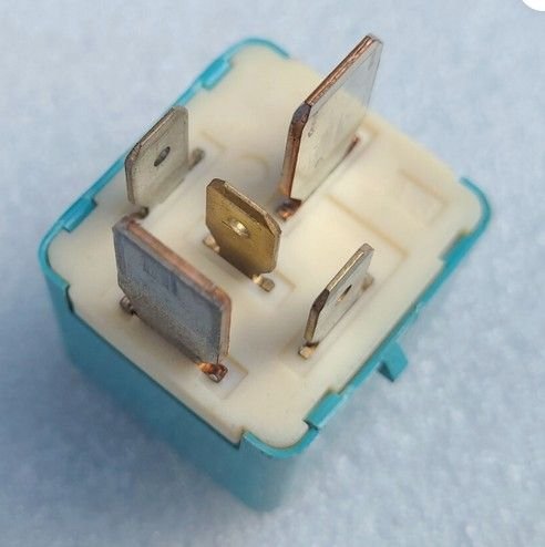

Pry at the bottom while rocking the relay back and forth. Here's what the pins look like.

As for the missing fuse or relay, it's labeled Inverter... but the car runs perfectly. Maybe a mid-year change where that part wasn't needed. I'm curious if anyone else with a Hybrid has anything plugged in to #2 in the pic.
