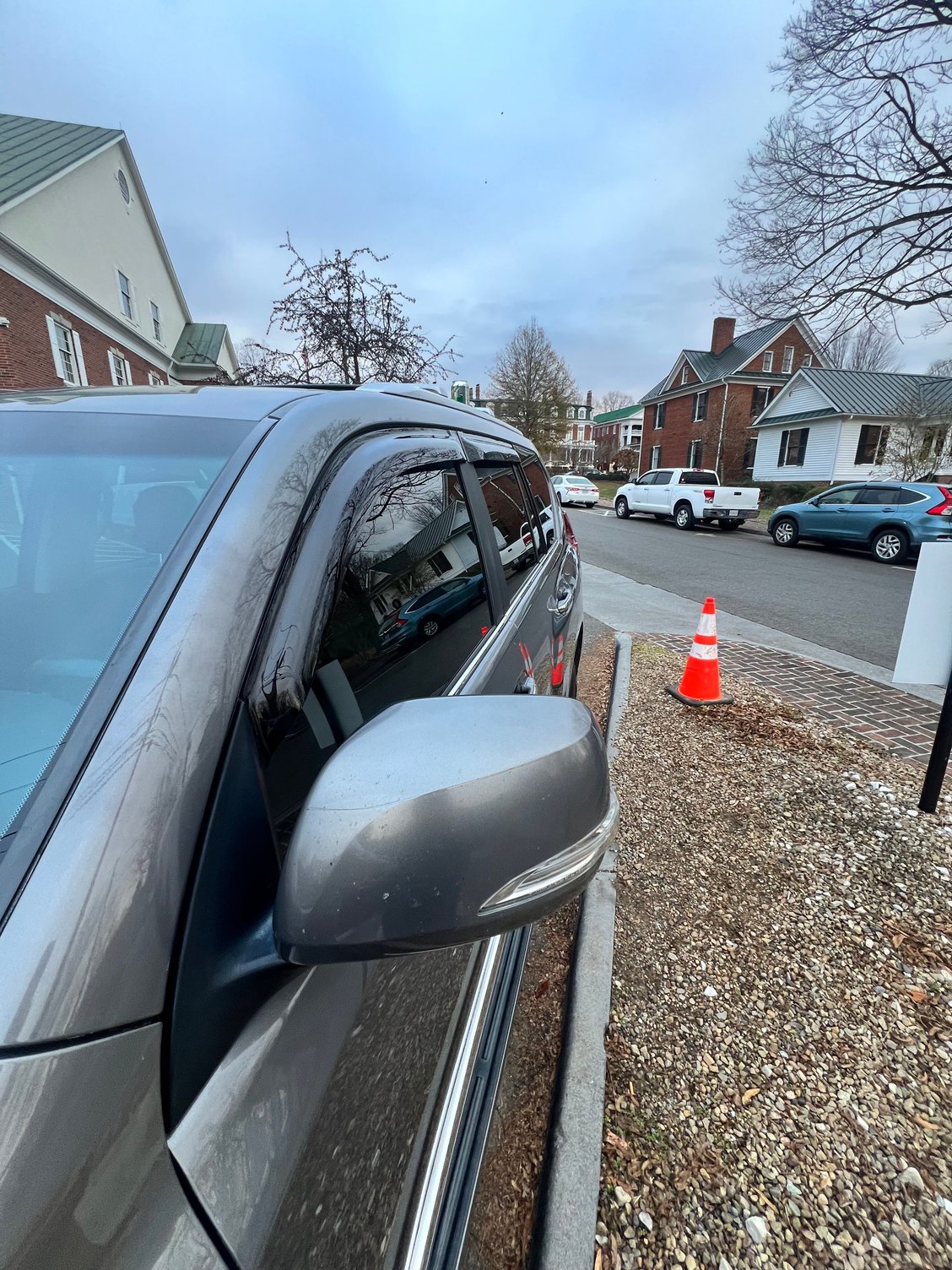

Those look nice. I’ve got the adhesive ones on mine but don’t recall who made them. Had purchased some Weathertech ones when I first got it and I returned them as they were so tight I could not get the windows to close without triggering the mechanism that keeps the windows from cutting things in two. Have had them on for about 3 years now and with more than 100 car washes under their belt. I prefer leave windows cracked to allow ventilation when parked outside in the summer. They blend in with the tinted windows too.

These are the ones I have from a better vantage point. Many car washes and no issues. These were eBay If I recall correctly and just adhesive, no clips.
