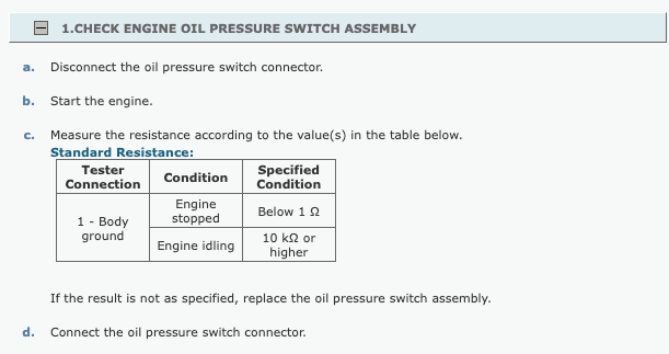

No engine oil temp sensor. You would have to use coolant temp. There are two oil temp sensors in the transmission (one on outflow from TC and the other in the pan).
Oil pressure switch is just for the warning indicator and not a full pressure sending unit.
